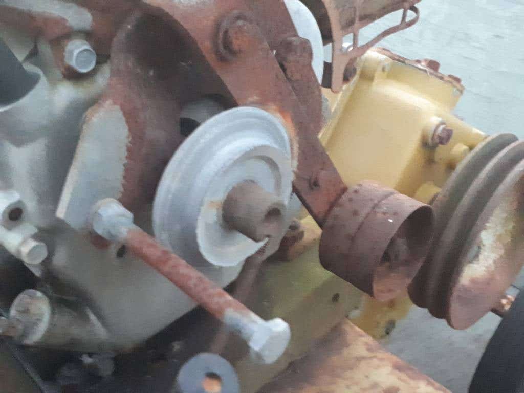

Hi usagrown, welcome to MTF by the way! That is awesome that you are saving your Dad's tractor. Please post up a thread when you do, myself and other members will follow along I am sure. Great to hear you have the manual, most are available in PDF download on other sites which is handy since I don't have the one for mine

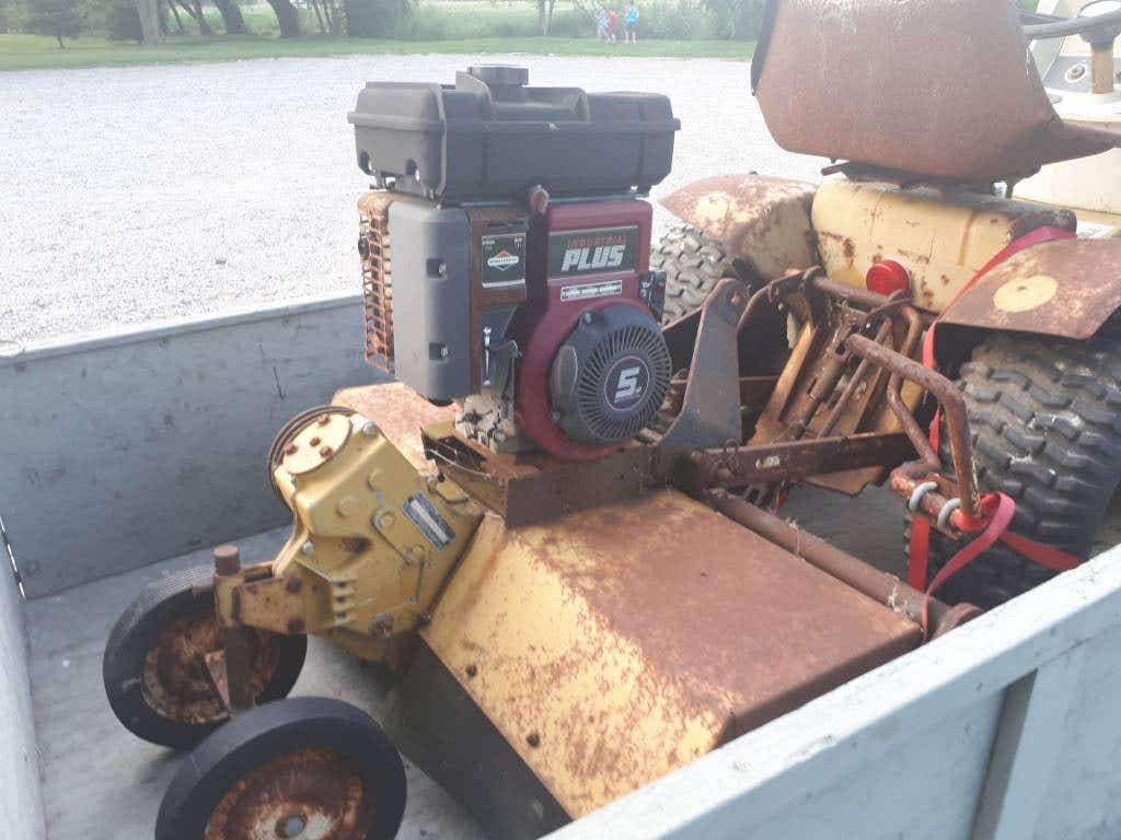

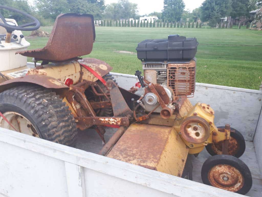

There is no stupid question, only one not asked! There is no PTO on these machines, as in an electric PTO clutch. These machines use the different engine pulleys and a belt. Every powered attachment uses a "mule drive" or belt tensioning system that is manually connected to the lever that is located near the foot rest. When you move the lever, it tightens the belt and then you have power!
I tried to attach pictures that I had saved for you as I am not near my tractors right now, the first image shows the mule drive for the sickle mower, it uses an idler arm to tighten the belt. The second is the complete sickle mower. 3rd shows the different sized pullies, 4th is the pulley view on the SS/16 and the final picture is a poor picture of the engagement lever in the bottom right corner
The SS/16 will be wearing the sickle mower comes spring
