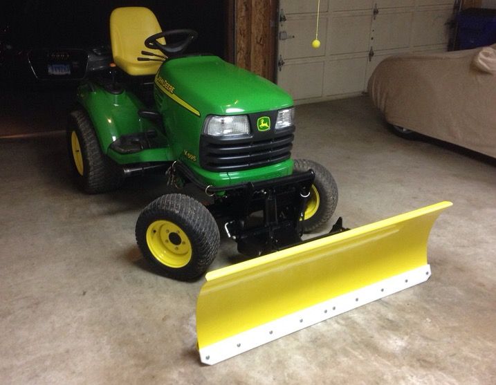

Shortly after buying a new 54" plow last year, I purchased a 1/2"x3"x60" piece of virgin (white) UHMW from Piedmont Plastics for~$35. I cut it to length and used the steel scraper piece as a template to mark for holes. The material cuts & drills very smoothly.
I will never clear my driveway with a steel edge & skid shoes. The UHMW edge worked perfectly all Winter, clearing my driveway and various others. I flipped it once for a new edge.
Even if I installed a new wear bar every year, I'd happily pay that amount in order to eliminate the steel-on-pavement scraping sounds and associated damage.
No need to pay $70-$80 for a UHMW edge - just find a plastics supplier in your area.
