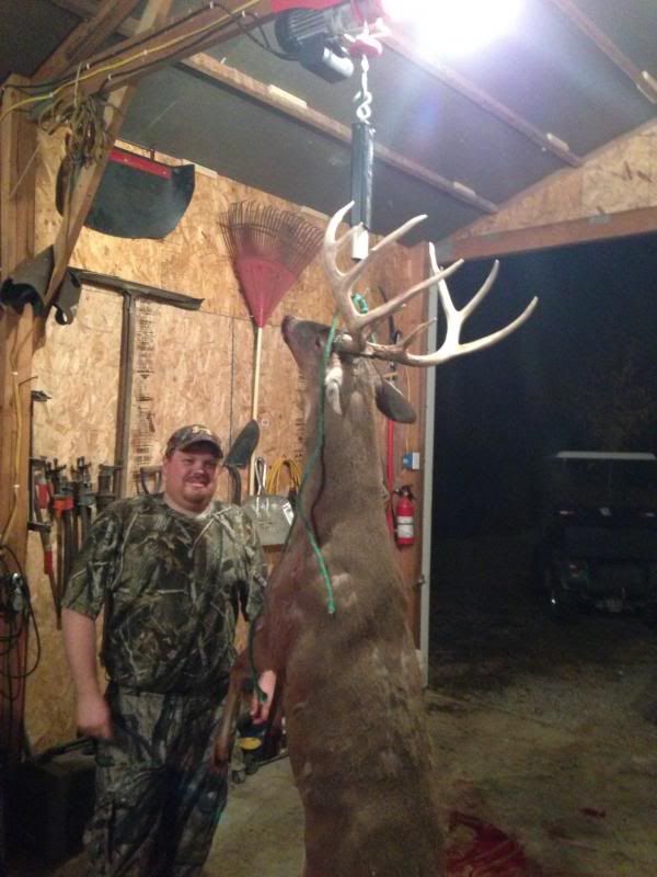

I put one of these up in my dads shed except it is the 1000lb model. I extended the cable on it by buying a new piece of cord that was 20' long I believe. Cord for making the new cable wasnt overly easy to come by if I remember right as it was a 6 strand cord or something like that if I remember right. I used all thread to extend the bolt length and clamped his directly to a truss in his pole barn that has 10' sidewalls. It has worked great for 5-6 years now, we use it primarily for hanging deer on to skin and butcher but it is really useful for taking decks out from under mowers as well. Usually unhook the deck and then hook the hoist on the front bumper and lift the mower up and slide the deck out from under it.
