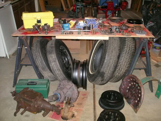

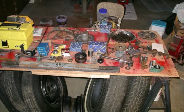

This is some of the parts. I had already modified the ball joint spindles and started the front axle.

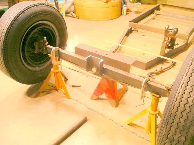

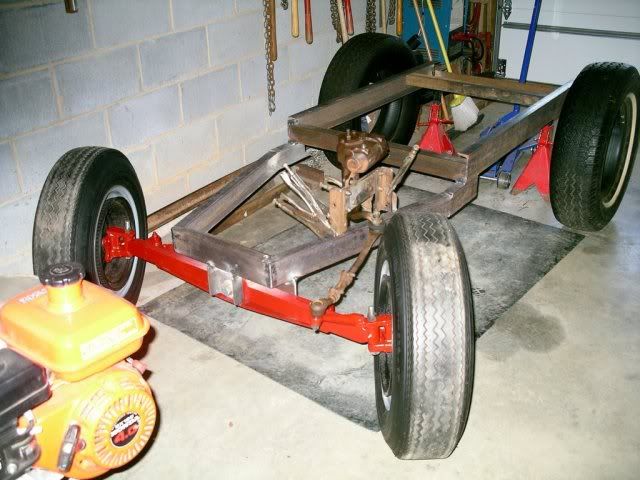

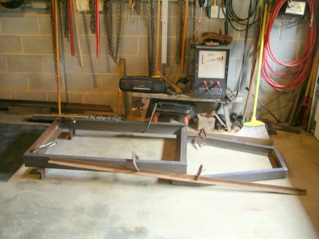

I've finished the front axle and started to lay out the frame. I built the frame in pieces because I had 9' of 3" channel and 8' of 4" channel left over from a trailer that I build 30 years ago.

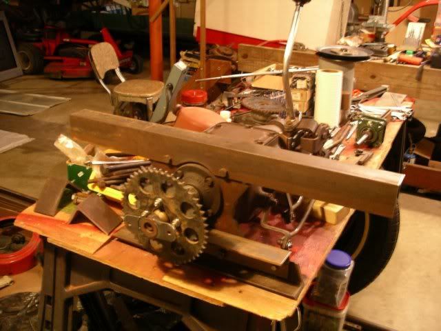

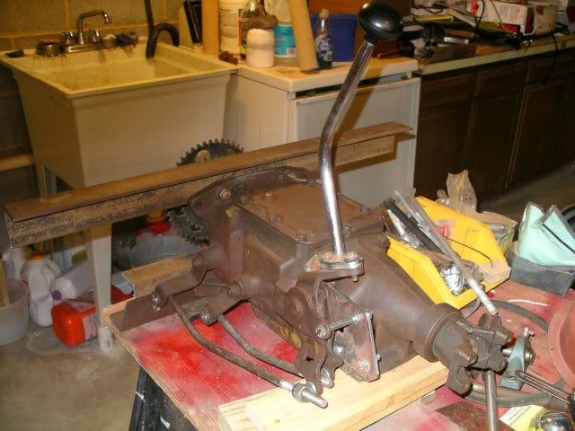

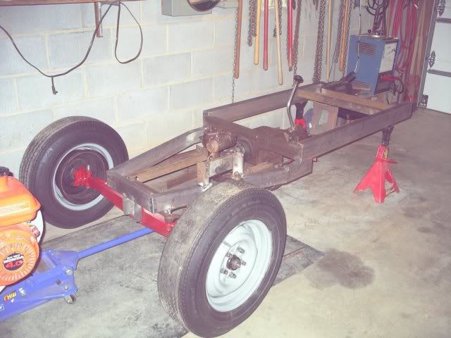

I mounted the transmission to the cross member, attached the sprocket, and installed the shifter. The transmission is a 71 ford truck 3 speed. The shifter pattern is backwards, but to fix it the shifter and linkage would have been too high.
Welding up the frame and installing the axle and transmission. This is where my camera broke. Got a new camera, but I can't load pictures up to my old computer, have to learn how to email them from my wife's computer. Will get you updated to where I'm at soon.

When I built my garden tractor back in '63, I used the front plate off an old generator which had the exact size bearing to fit the end of the input shaft of the '38 Chevy tranny I used. You definitely need support out at the end of that input shaft; it is NOT intended to have that kind of pressure placed upon it.

The support bearing is on the front of the trans. in the sixth picture and will be bolted to a cross member.. The sprocket is mounted with the center out of a clutch disk with the help of some brass spacer bushings made from a pressure relief valve for an old water heater.

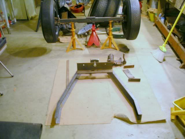

Here is a few more pictures. Install new brake drums a shoes as that was one of the things I didn't have. That about wiped out my build budget. Still don't have an engine, may temporarily use a small Kohler or Wisconsin Robin I have.
I have most of the fire wall cut out but I want to try it out before I install it.

Thats a nice build! I spotted that Ford gear box a mile away! What model is it? I can understand a certain amount of thought went in to this project! Should you not incase the chain part?...to hold oil? Cant wait to see what you choose for a motor!
