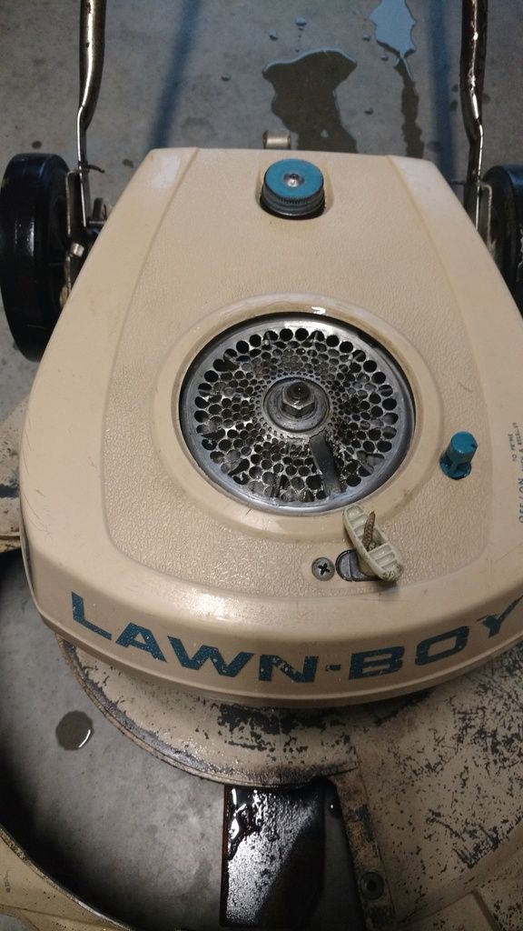

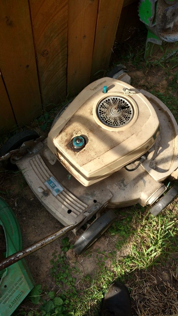

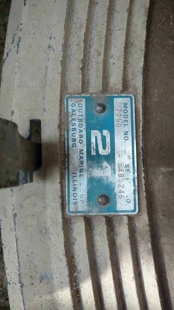

Well, I know I've said I wasn't going to drag home anymore Lawnboy's......but I ran across this old 7259.

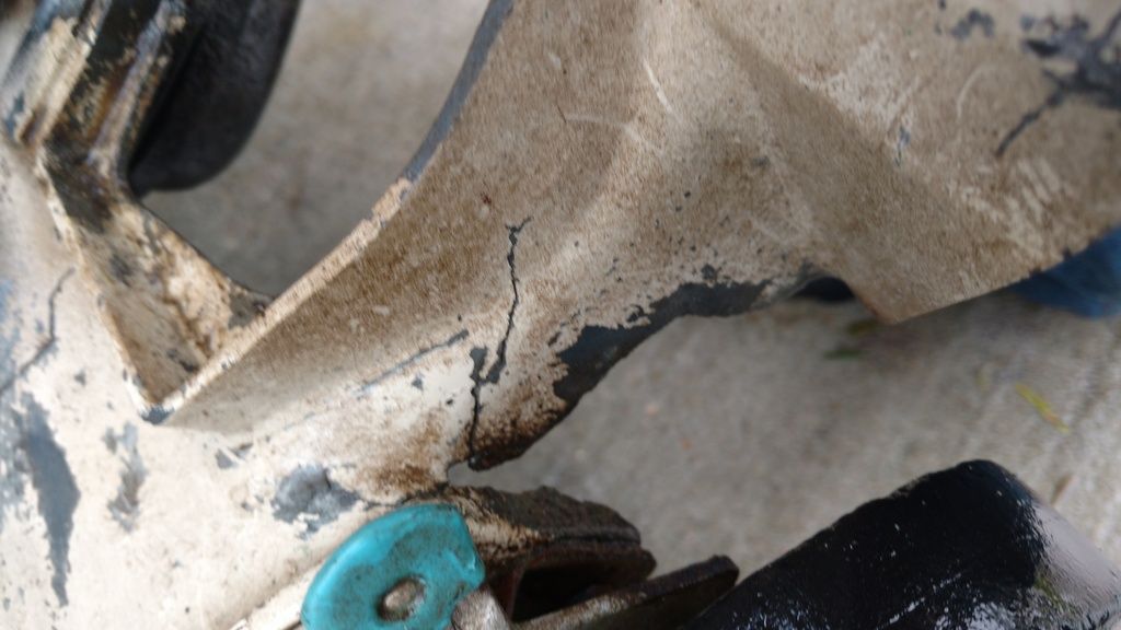

I was excited because I didn't have one this color yet...but then came the inspection. The mag deck appeared to be in decent shape at first glance....but then I discovered a crack behind the discharge and found the deck was worn paper thin...scrap metal.
I had my sun glasses on and the wheels are a bit dirty, but something seems different about them...I can't tell if they are white or beige....but the rear are mag style on the outside, but not on the inside.

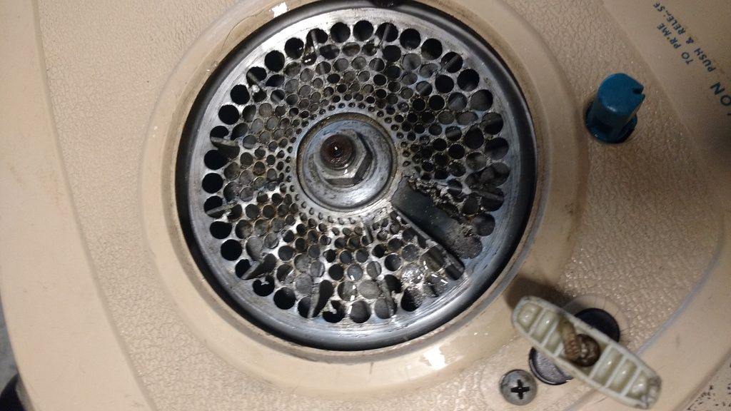

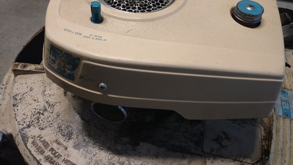

The shroud looks to be in very nice condition, and the engine seems to have low compression.
I think I will compare the shroud with the one on my 68 as it is in better condition.
All in all...looks to be a parts mower....but if the shroud works out for me, it will be worth the $20 I paid for it.
Lee
#2 ·
Nice find! 1969, the last year for the dual bronze bushings in the residential D-400's. I've had a couple of those engines (D-407), one is in my 7260B and both of those engines actually have steel bushings instead of bronze, babbitt I think is the correct term, not sure why they did that, but they seem to work just as well as the bronze ones. My 7259 mag deck was also shot so I tossed it, those mag decks are really prone to cracking and severe corrosion. I have a quart of the bermuda sand color custom mixed in acrylic enamel and will post the color code on the 1967 Lawnboy edger thread if you find a good deck and want to do a restore. One other thing, the 68 shroud is a different style than the 69 shrouds, those style shrouds used on the 7259 were used from 1969 to 1974, I think that would be the 3rd generation fiberglass shroud with the 1965 a one year only style and 66 through 68 being 2nd gen and your 7259 being the 3rd generation. Those wheels are beige for 1969, I think that maybe the only year for those color mag wheels.

Well....I just compared the shrouds, and they are different.
Think I will remove the engine and a few other parts and thrash the deck and handles.

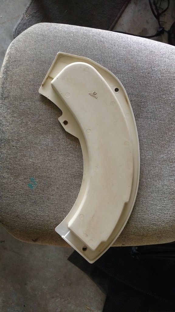

Well, I started to assess the 69 today....first question...will it run.
https://youtu.be/dWRniywZISg.
Next question....what is salvageable?
It turns out that none of the wheels were original. But I will keep them around along with the adjusters.

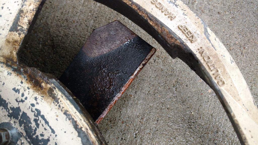

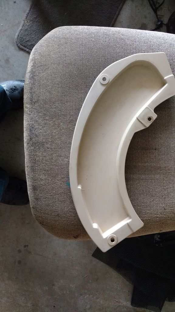

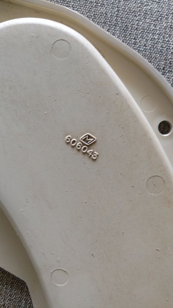

The side discharge cover however is original and in nice shape....also looks like a fairly new blade.
Guess I will keep everything but the deck.

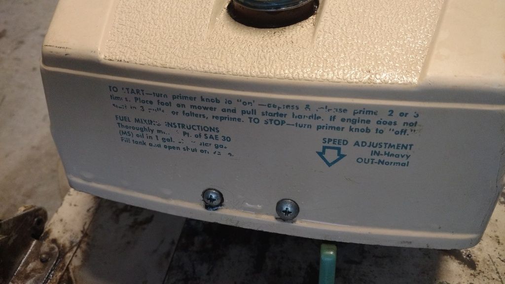

That shroud is in incredible shape! It's a real shame the deck is gone.
Too bad you weren't closer as I have a really nice 21" deck that would work for you. You're right about the wheels though. I'd be surprised if you'll ever find a set of cream wheels. You could always try painting them, not sure how the paint would hold up on the plastic though.

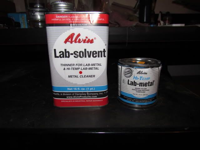

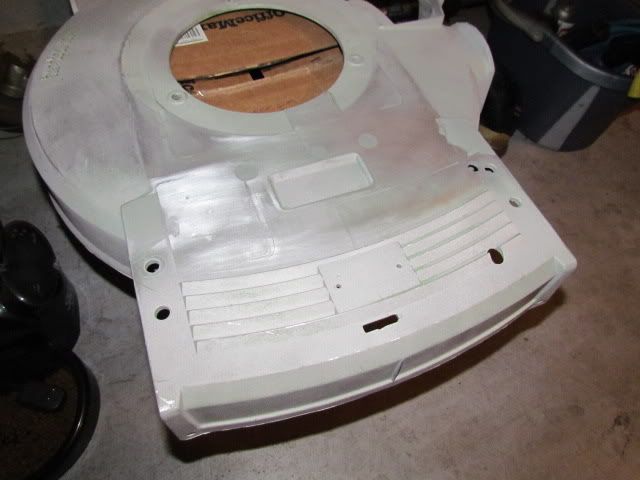

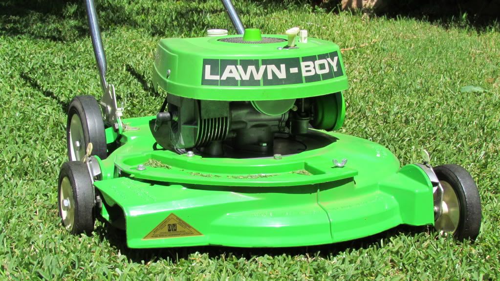

Lee I wouldn't limit your search for a new deck to just mag decks only. I think an aluminum deck like what was found on models like the 8255 would work just fine. The self-propel holes would need to be covered up and lab metal would do the job just fine. This 7260B would have been a 7259 except for the fact that I had this immaculate 1973 shroud so it became a 7260B. I still have a set of decals for the 1969 model 7259 and had always thought in the back of my mind that someday I would do this model in bermuda sand and stick the 7259 data plate back on it.

If you look in the first set of pictures in this thread, you will see an 8235AE sitting right behind it.
I discounted this deck because of the self propelled.
I will have to give it a closer look when I get back home.
