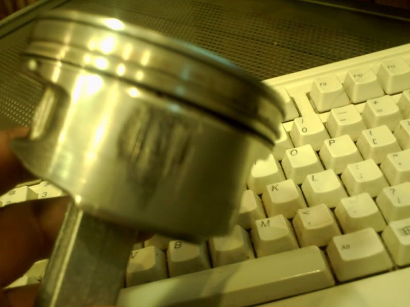

23hp Intek V-twin, 2007 model on a 2008 model rider, the engine ran fine, fired right up, but consumed about 3/4 quart an hour and required the plugs to be removed and cleaned in 2 hour intervals.
So this engine was given to me when I put a new engine on a guys mower back in like June of this year. I determined at the time that the engine had signifigant wear based on just removing one head and sold a new engine, I just had time to tear the engine down...
Removed the plastic shroud, and the sheetmetal guides, removed coils, flywheel, tin under flywheel, and the 2 harnesses.
Then removed the governor controls and the other head.
Then I removed the sump and popped the rods out...they slid out with no effort. The top rings are able to fall down their respective cylinders..no tension, and about .450 ring end gaps...hahaha
Both cylinders will clean up easy enough, no scarring at all, no wear in the ring inversion zone either.
The only bad thing I found besides the rings, were both rods had the early signs of thermal breakdown and metal transfer. Thankfully iy didnt pile up on the crank, but this engine was not far from tossing a rod or 2.
The other thing is on the upper cylinder, there is some skirt damage from running dry.
I think all problems can be resolved with some new rings, and some fine fine emory cloth to polish it all up...
Here is the worst of the 2 rods, and the worst of the 2 pistons.
You can see how far the rings are sunk into the ring lands....badly worn.

I'm enjoying your engine posts.
Do you find it unusual that the rings could wear so much but not the cylinders?
If the engine avg'ed 50 hrs a season since 2008, it looks like that engine approx 150 hrs on it.
Was this one of those Intek's w/the poor fitting air cleaner?
Dave
#4 ·
The owner got the tractor in 08, right away he lost one of the 4 air filter box screws..he said it started smoking within a month and he used it until it started belching smoke and oil...so it took him about 2 years of gradual dirt consumption to kill it.
That 3 dollar screw could have saved this engine...

A friend says he might have a pair of like new rods out of one of these I can use, id like that more than using these cleaned up rods...if its available.
Apparently briggs doesnt want to sell ring sets for this engine, they want to sell a ring/piston assembly..haha, nice try briggs. Found seperate ring sets online...haha
