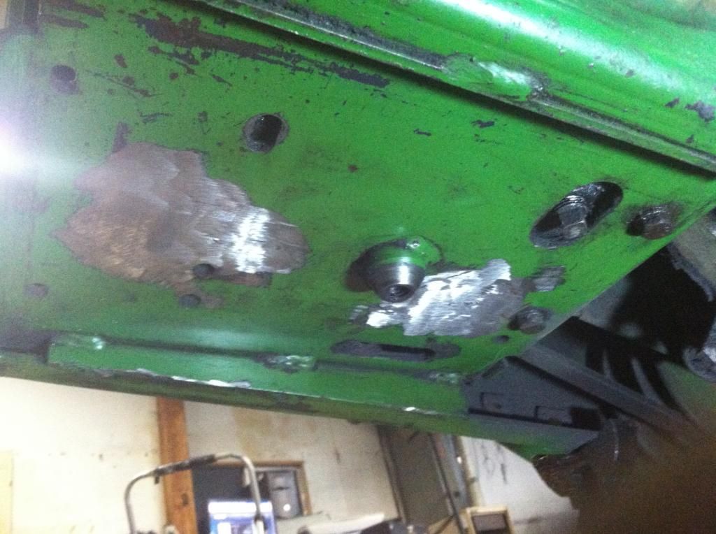

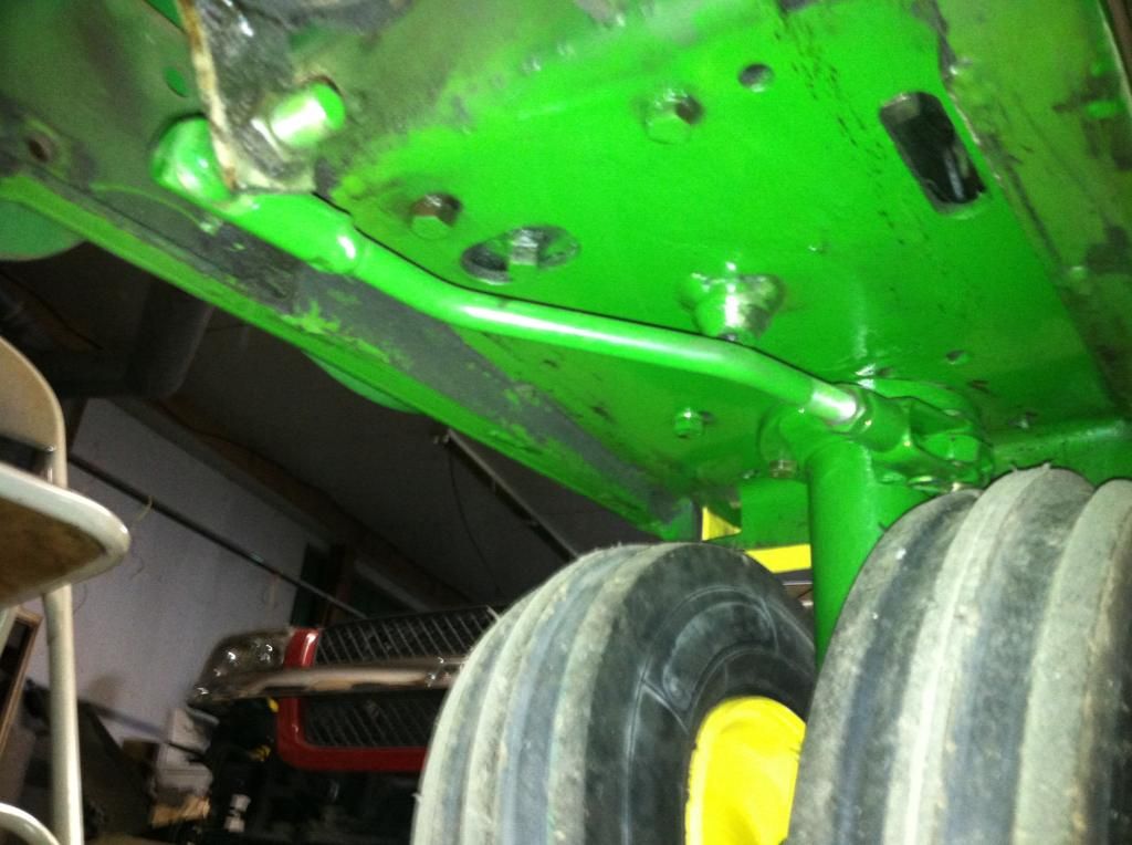

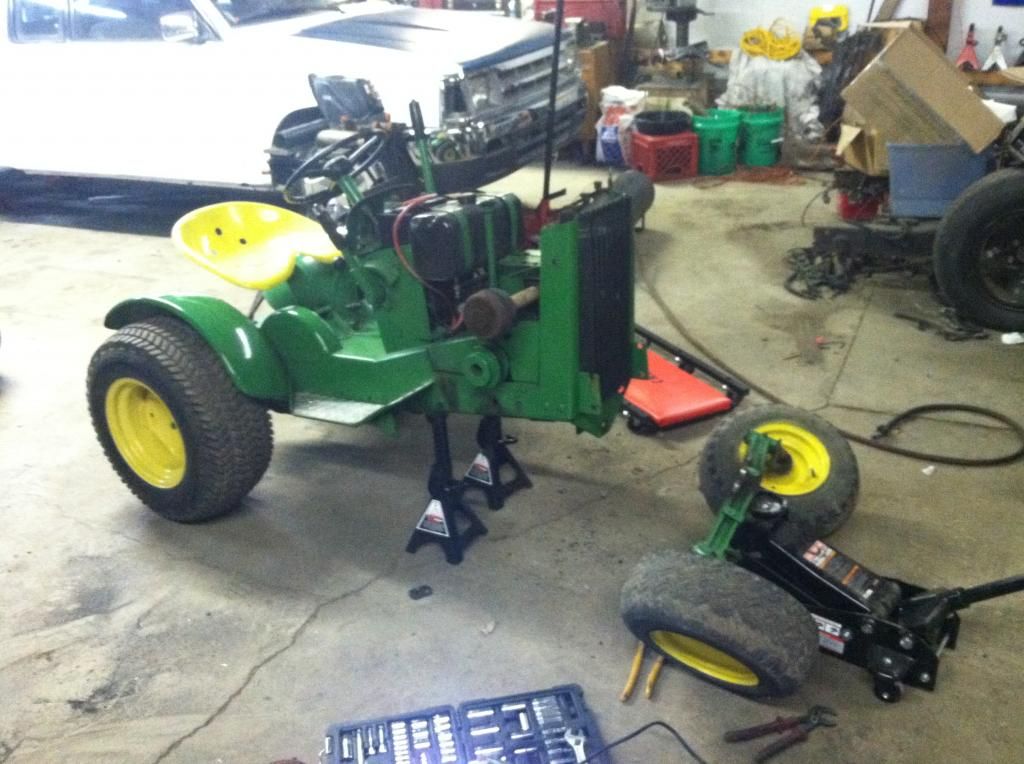

I know this isnt hard job to do, but I thought id share anyways for anyone who wants to see.

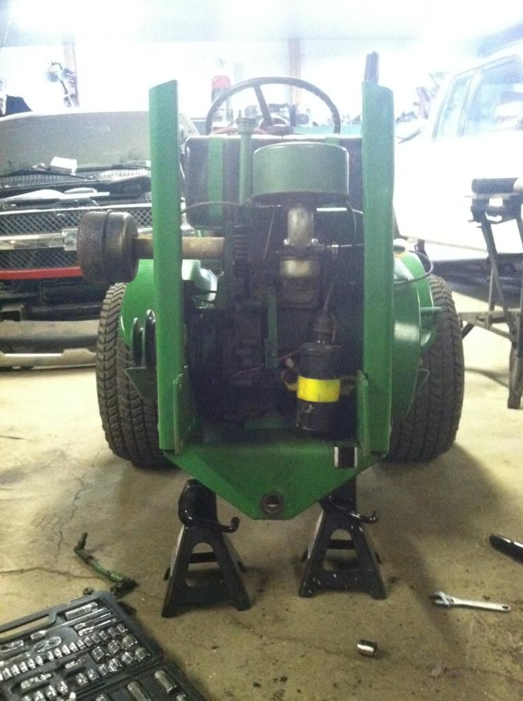

First jack up front of tractor and place 2 jack stands under the tractor,

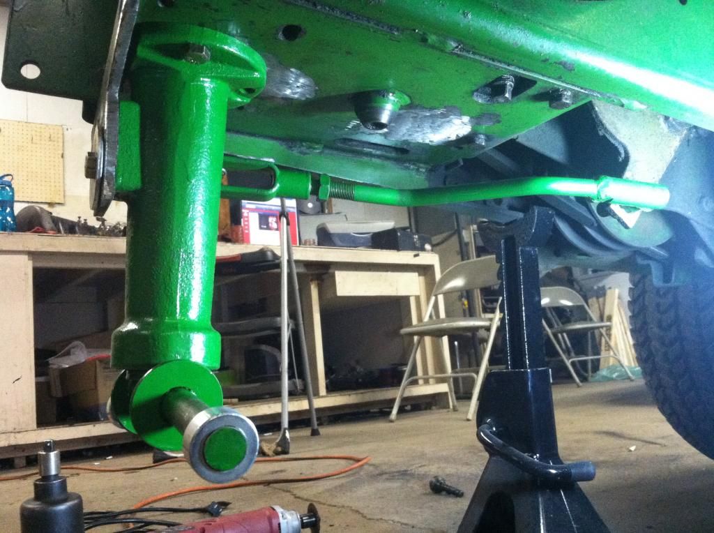

Next from under the tractor remove the steering arm nut that attaches to the steering box. Then remove the large center bolt and nut that goes threw the front axle, and the bolt that goes up threw the center of the steering bracket.
Next take off the hood and the grill, you will need to drill holes behind the grill

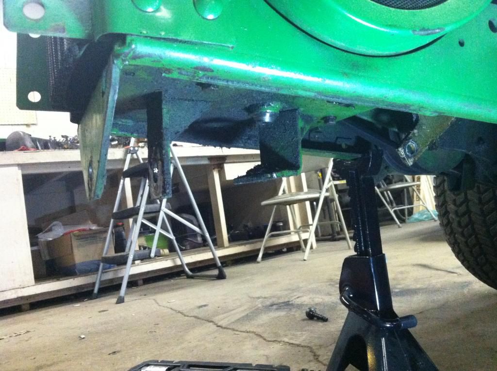

Next, there are 2 brackets under the tractor that need to be removed, i used a swazaw and grinder, but a torch could be used just be careful.
after

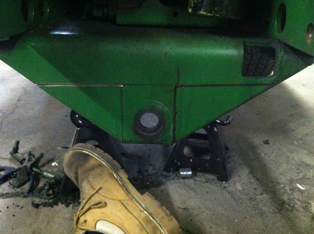

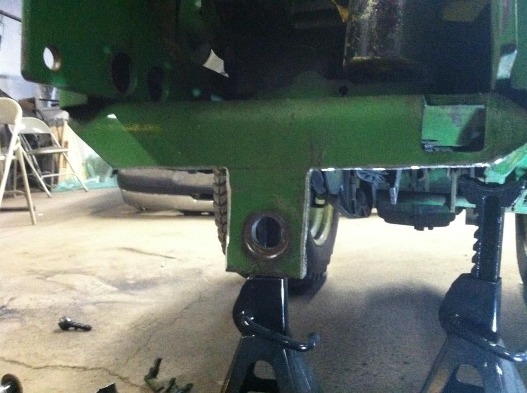

Next where the front center bolt goes you need to cut away some material.

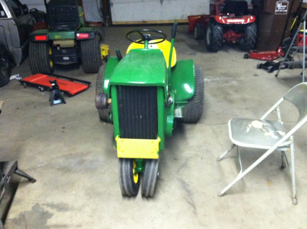

Then you will need to drill 2 holes for the new set up to bolt up these are the 2 holes you drill that go up behind the grill. After that just tighten everything up after painting the bare surfaces
Now sit back and enjoy your work

how tight does ur's turn a corner now..
can u post a pic with the front turned full one direction..

It would have to have a Ross Steering box,I think,but with power steering the cylinder could be moved to the center.
#26 ·
Don,I think u are right,there must be a slot cut in the side to attach the steering arm to,I wonder if he uses the axel as well?
