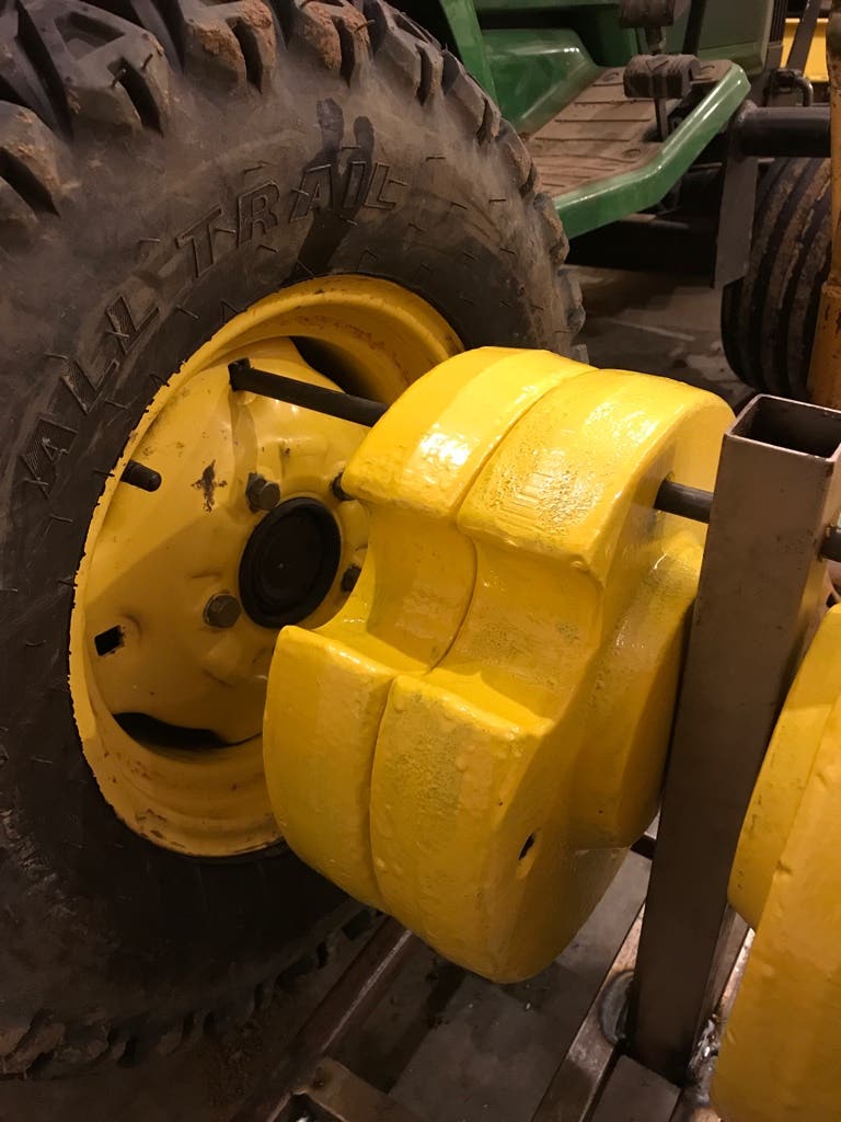

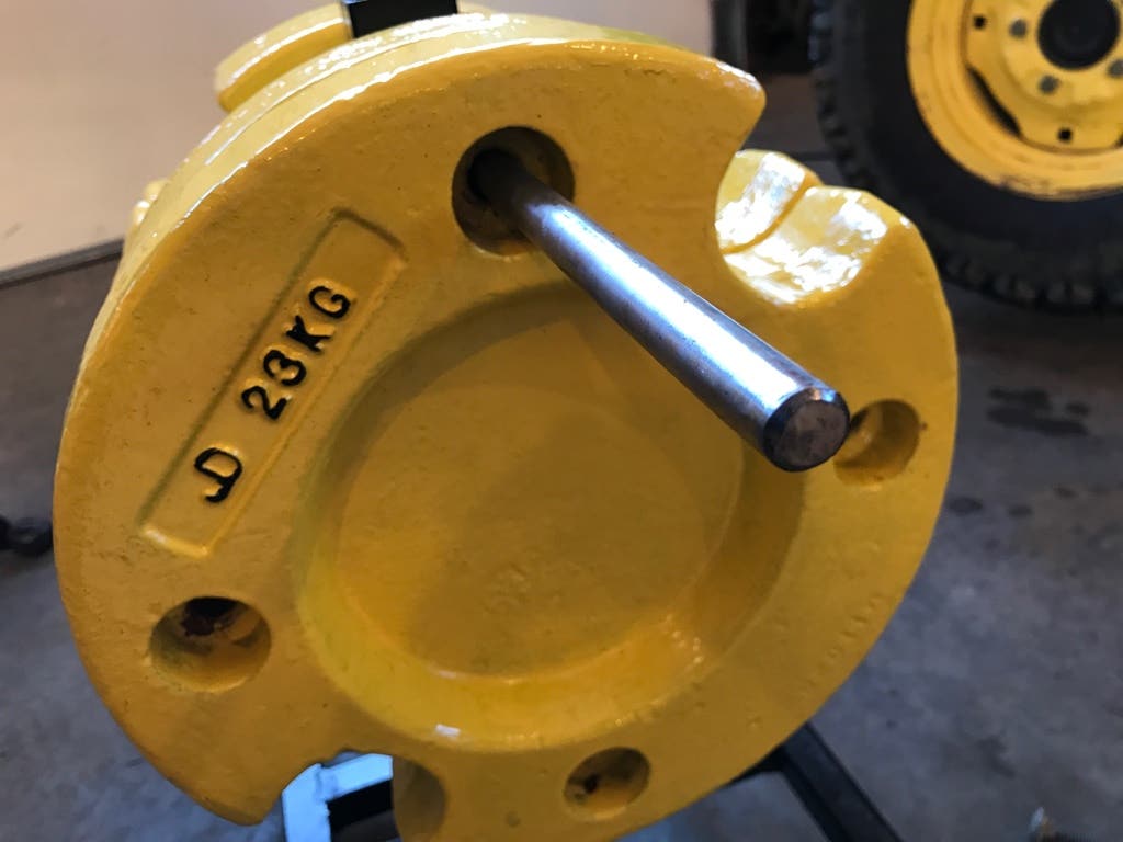

I just wanted to share a dolly I made to store and install my wheel weights. I’m pleased with how it turned out, and the rod being long enough to set into the square hole on the wheel makes sliding the weights into position easy and correctly aligned to the other bolt holes.
Your welds look like dog crap and your paint job sucks too. Tell you what, I'll take that weight rack off your hands for free and save you the trouble of hauling it to the dump. :D
Just kidding, great job on that man. Innovation at it's finest.
Great design. Only thing I would do is add some way to adjust the height of the rods to allow for the hole in the wheel being slightly higher or lower due to various factors.
I thought about adding in that feature and decided it was a better solution for me to just use a floor jack on the tractor to lift the wheel to the right height, that way I can rotate the wheel for hole alignment also. Also I’m lazy.
