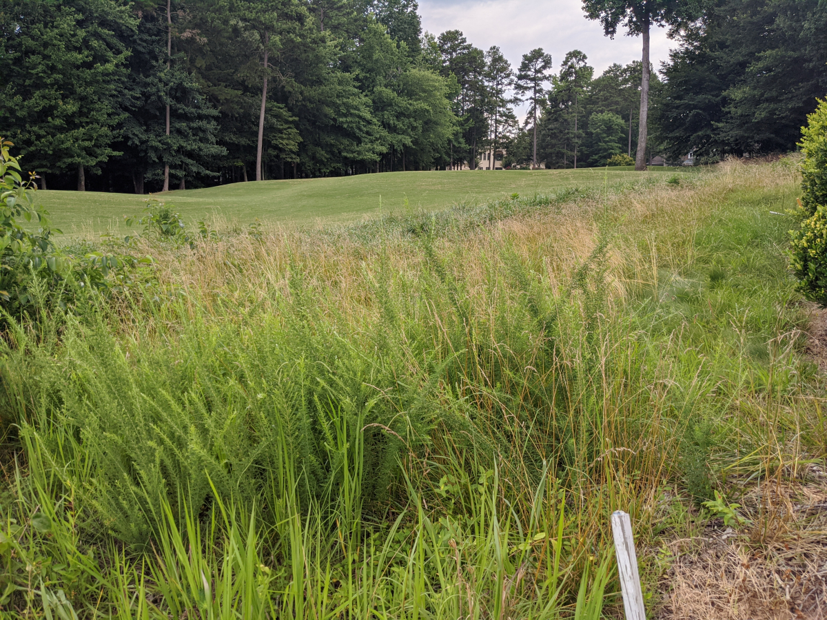

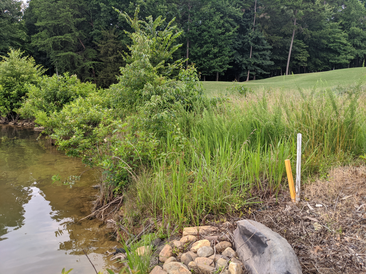

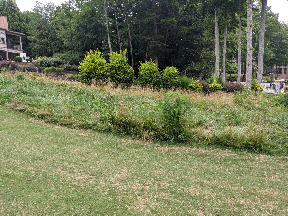

Wondering what the towing capacity of the x738 is on an incline. I have seen people move much heavier trailers on flat. Looking to emergency tow a jet ski out of the lake at my parents. It takes on water so trying to get it to a regular boat ramp to put in on the trailer isn't really possible. It is on a hill probably about 12-15 degrees at some points. Less though where I would be pulling it out of the water. Trailer is about 380lbs + 957lbs for the jet ski full of fuel. Is my x738 capable of pulling such weight. It would only be a short distance. Maybe a few hundred feet to the first spot I can get my truck too.
I would be using my click'n'go weight bracket that has a 2in hitch receiver on it to mount the hitch ball.
Here is a few pictures of the area.
