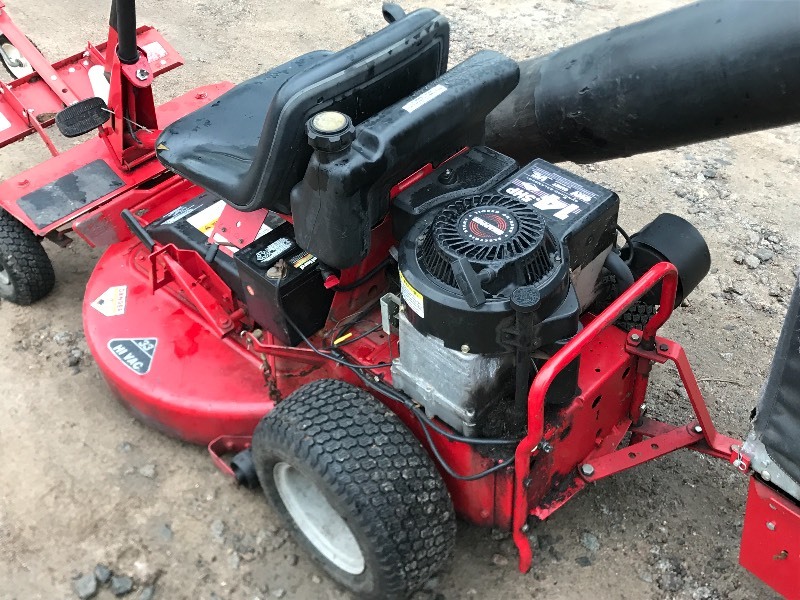

Ok so now I'm back to that **** won't work unless I make it different. Here is the part that I do have I found a manual!! Snapper has some crazy setup for this trailer. Mine doesn't even match the one in the manual?
Anyway it won't work to make that tubeular hitch because the bag-n-wagon sits higher then the snappers hitch. Can still work will just need to bend it.

Here is a picture I found from on a auction site showing things.

#23 ·
Why did this manual never show up in previous searches?
That’s the one i have, it’s tricky getting it on assembled but works well
