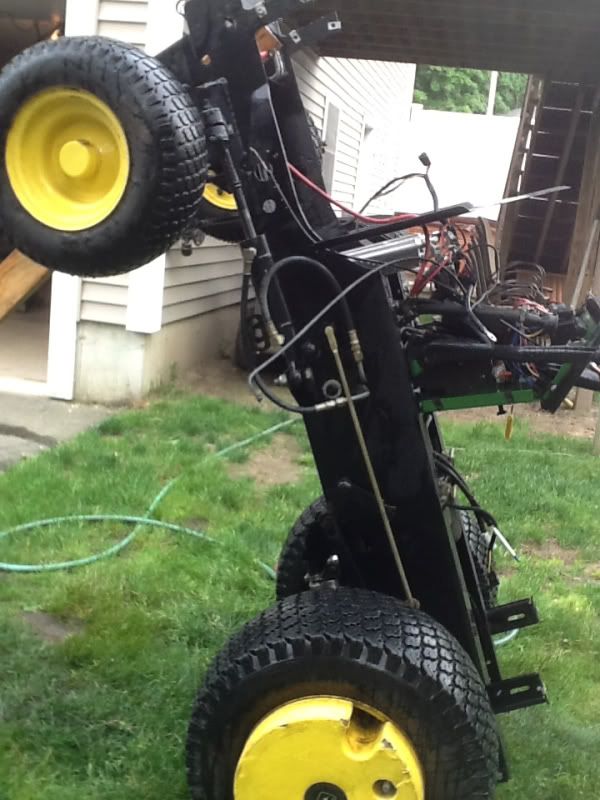

Well i havent posted in awhile but i still have been tinkering with the 318. I got most of the tins ready for paint plus built a make shift spray booth.

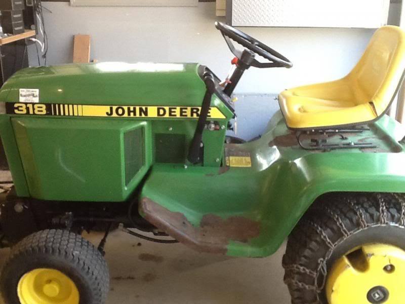

Ive been trying to decide on a seat option first i hated the seat bracket/spring setup and the going rate on the suspension style bracket is just too much. So while crusing ebay i came across a seat bracket for a 240 which is also adjustable with a starting bid of 9.99 i was the only bidder so mine now. However once mounted to the tractor the orgional piviot point for the seat made it sit to high so i lowered it and ground down the side brackets so the seat would still tilt forward. Now its time for a seat with arm rests.

You will enjoy that coil spring seat much more than the standard U-shaped spring seat that came on your 318. I did the same thing to mine. My seat came from Evil-Bay as well it was made for a John Deere 345 Tractor and I modified mine placing some heavier coil springs towards the rear of the seat track as shown. I bought the heavy duty coil springs as Lowes they were intended for a Porch swing with a load rating of 325 Pounds and now work in conjunction with the original ones that for me were too weak to carry my weight level when seated I weigh 250 Pounds. To get the most Travel out of the adjustable seat frame I had to grind the rear portion of the seat Tracks a bit so that I could mount the new adjustable seat frame farther back on my fedner pan as I am 6'-4" and wanted all of the rearward travel that I could get out of the new seat frame once it was mounted. Now with all 4 coil springs in it's frame work it is a heavy duty style that works well with me. I then bought the John Deere seat cushion repair kit which cost me $69.00 and replaced my torn seat cover & it looks and works great now, I have a grand total of $94.00 in mine which is a far cry from what an Original Heavy duty style John Deere flip suspension seat frame cost's for these 318's that seem to go for around $300.00 Used. :fing20:This seat cushion repair kit is a direct duplictate seat cushion matching the original one right down to the embossed leaping Deere in the rear upper portion of the seat cushion as shown. Regards, Hammerdown
Discussion starter · #55 ·
Looks good hammerdown already just from testing it out for adjustments i can tell im going to like this setup alot more than the orgional. Im not that big of a guy 5'4" weighting in at 165ish soaking wet lol. I had to lower the front of the seat because i couldnt reach the floor boards no joke.

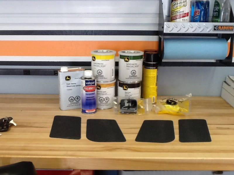

Discussion starter · #60 ·
Well i have got a little spraying done over the weekend. Everything except the fender pan has been etched primed and the sprayed with JD primer sealer. Im am very pleased with my make shift spray booth keeps all the fumes outside and not in the house.
The booth is 8x8x7 with 2 20"x20" intake filters and one 20"x20" exhaust filter ducted 10' out my window with a 20"x20" box fan.
