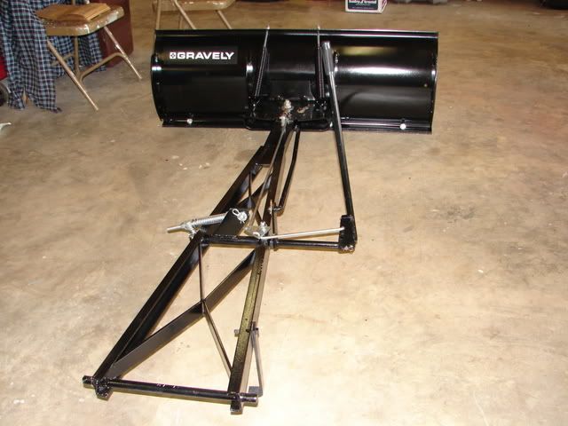

This next one has yet to be tested, since the snow dozer frame is still at the repair shop. But my calculations suggest this will apply about 30 lb of additional down force on the dozer while still allowing the full floating action.

The spring specs - 1" outside dia., 4" overall length, wire size aprox .125", aprox 16 coils total. I measured about 90 lbs needed to compress the spring, so based on the position of the axle mount relative to the lift rod and the blade, I estimate about 30lbs of force transfered to the blade.
hey i need a new linkage for my dozer blade. know anywhere i can get that bolt setup?
#11 ·
This is just the stock Gravely parts with the spring and a few washers added. The stock Gravely rod for the dozer has two dimples/that prevent the slide from going all the way to the bottom. I just slid the washers and spring on and put it back together.
The trick was finding the right spring - specs listed above.
You can click on my picture to inlarge it and take a closer look.
Sheldon

#17 ·
Update:
The snow dozer is painted and re-assembled.

#20 · (Edited)
When I received my new brake shoes, I gave them another coat of paint.
I don't want a repeat of what happened the first time
Golly, what a great looking bunch of parts! You should be proud.
#22 ·
When/if I repaint my rider blade it will definitely go back all black. Easier to touch up in the long run and the sun should warm it to melt snow off better.
