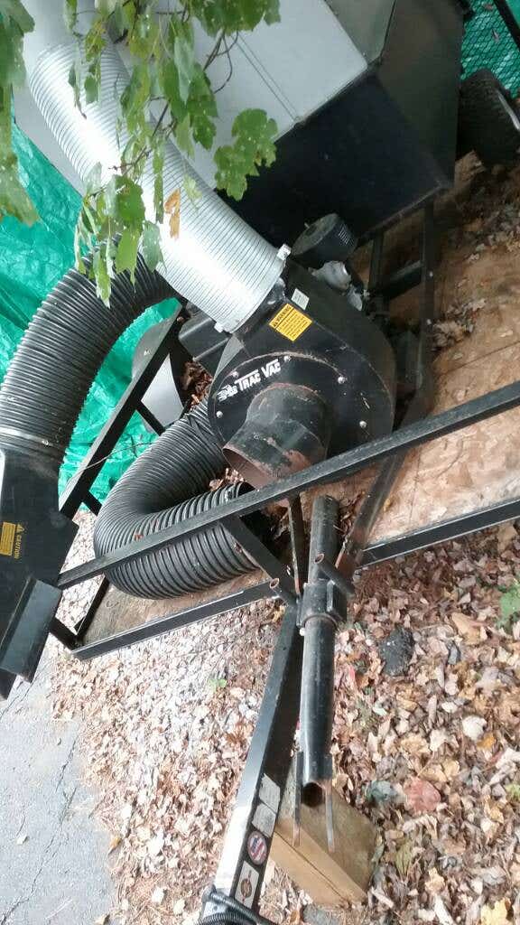

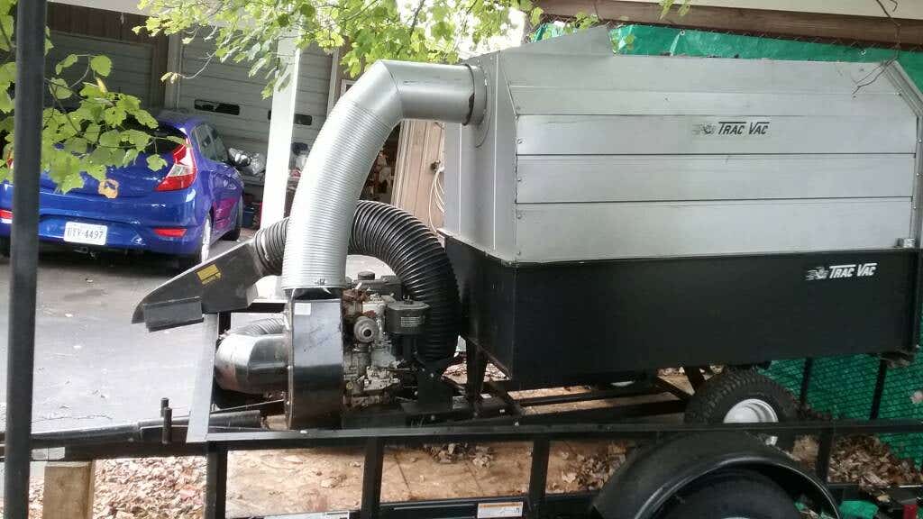

I bought a Trac Vac 880 from a fellow that runs well but I'm trying to figure out how to use it. I have the manual and three mowers. Two Cub Cadet zero turns one a Z-Force with hitch bracket and an old Power King tractor with belly mower.

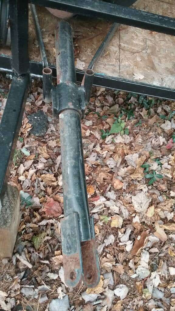

It was all the owner and I could do loading Trac Vac on my trailer since motor bracket welded to it's frame. Tongue weight probably 150# at least.

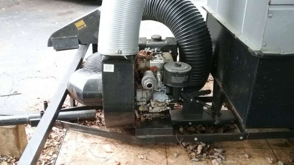

So first problem is manual shows blower motor on a bracket mounted to mower.
Second problem is attaching discharge chute to mower?
I'd be happy using it as just a leaf vacuum, I would need about 30' of 8" hose if that would work?
Thanks
1. I've yet to see one with the blower mounted on the tractor.
2. The tube that you have not connected is what you use to connect to the mower's discharge chute. If you were to google for images, you would see lots of pics showing the attachment.
#3 ·
The part that connects to the discharge on the mower deck is called the deck boot. They are often specific to the deck and have a mating piece like a hanger that bolts to the deck, but I've heard of universal boots, and/or you can get creative in how to attach it. If you decide to figure out your own attahcment system, keep in mind it should be easy to quickly remove out in the yard for when it clogs.

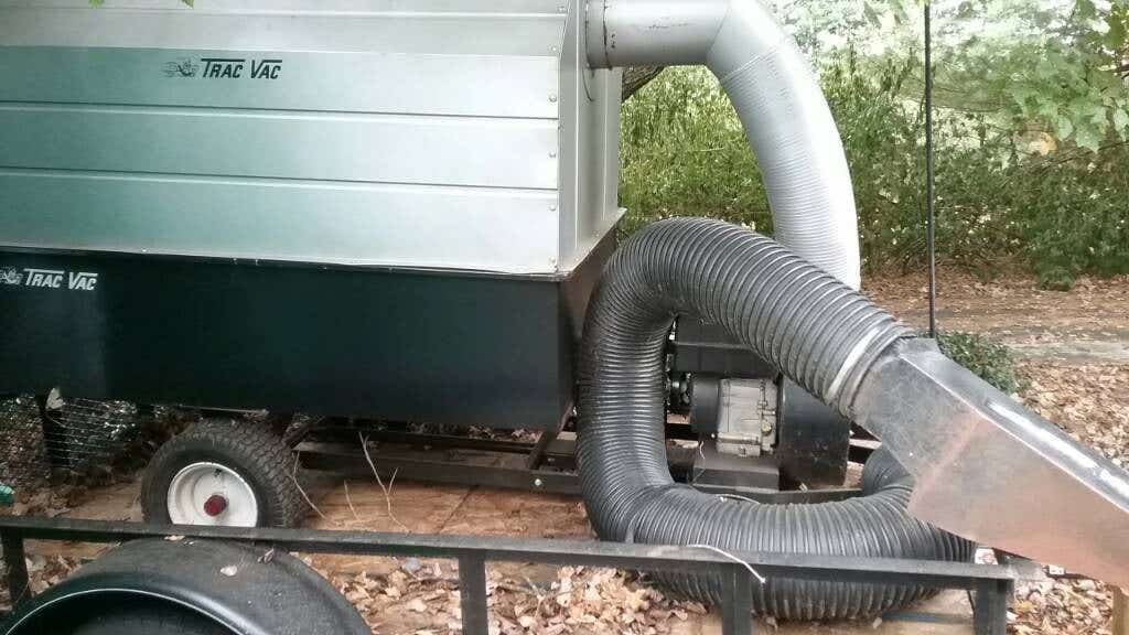

#9 ·
Thanks all! It works great on the Cub. It turned out not to be a problem with tongue weight (even with my 212# lard[emoji16]). It was way easier than I thought. Discharge I was in a hurry so vice grips (I'll fix it better later, bolt on adapter I can easily fabricate).
It also has a broken door latch I'll need to fix. For now it leaks out the door so not as efficient as it should be. The dump feature also I'll mount an old rake on it. It would only dump over a bank as is.
Funny it ran great, then cut off (I had rebuilt the carberator). Only tool I had was the vice grips. No fuel coming into carb through cut off valve. B&S 8hp. Turns out fill cap was too tight! Letting air in it works perfectly (cap snug, not real tight).
In pictures you see where I did and didn't make a few passes.
I may order 8" hose...it's expensive but would be handy sucking leaves in overhangs, etc like a big vacuum cleaner.

You have it hooked up and working now but,
TV makes 2 versions of their units, one that mounts the motor/blower on the trailer frame (1080), and another that mounts the motor/blower on the back of the mower (1060), usually a zero turn but it can also be a reg tractor, either without w/o a 3 point.
I have the tractor mounted version but plan to mount it on the trailer so I can use it on different tractors.
