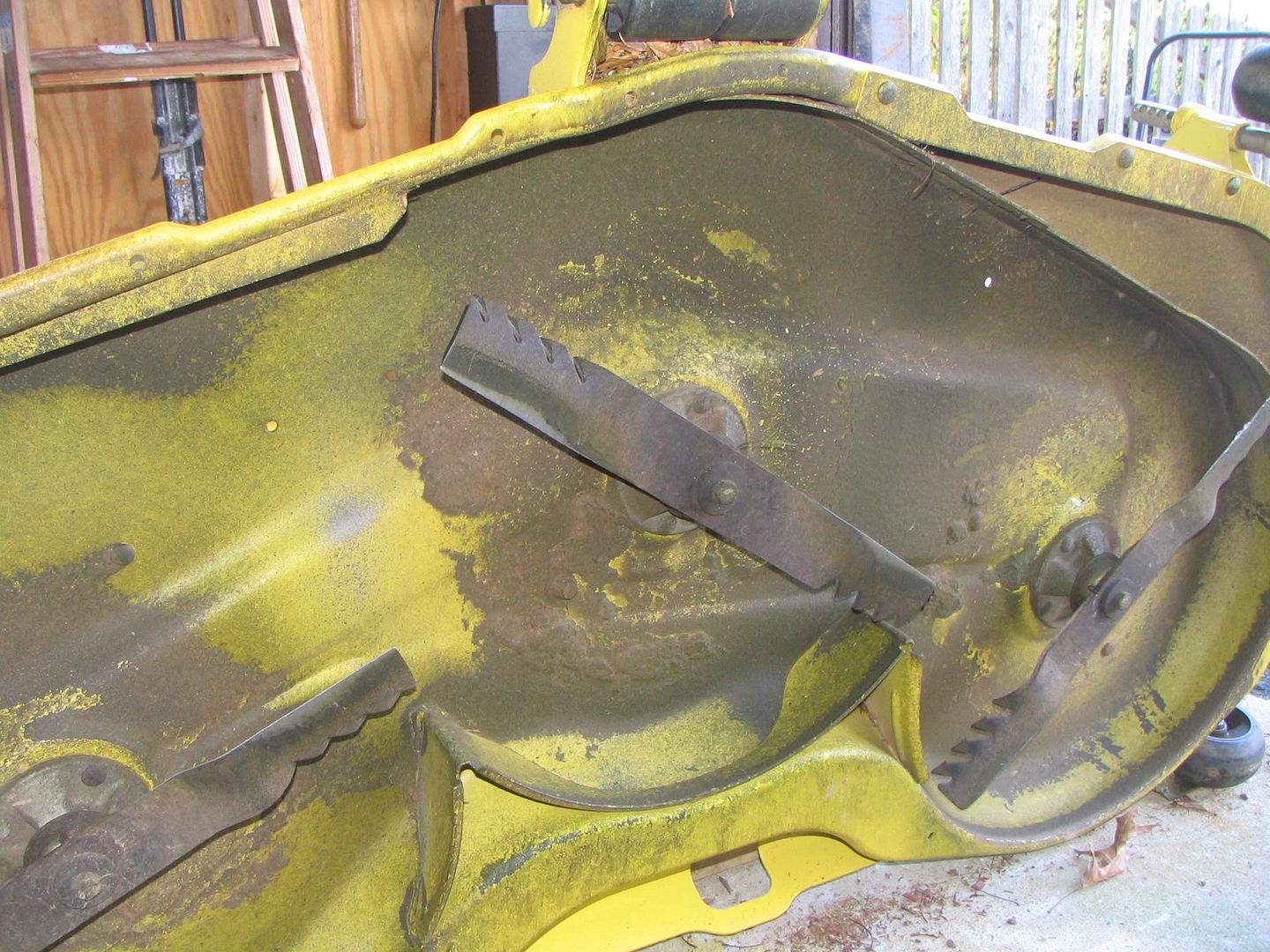

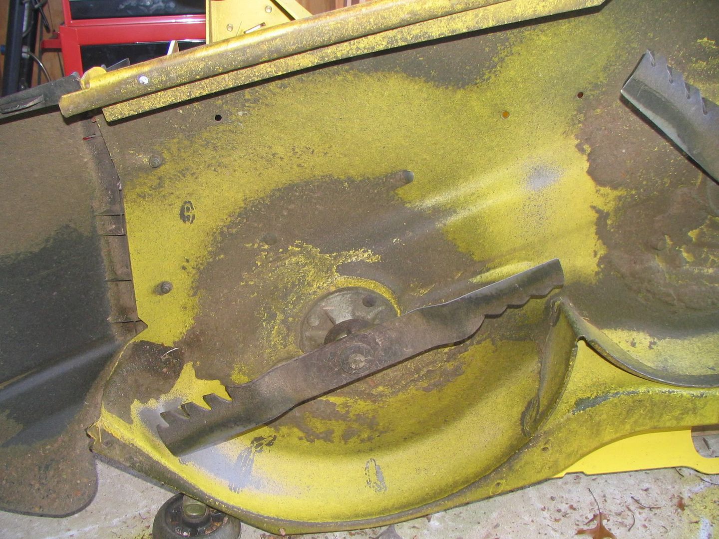

You're supposed to clean your deck? Why? Here's an untouched deck with ~ 50 hrs. of use:
