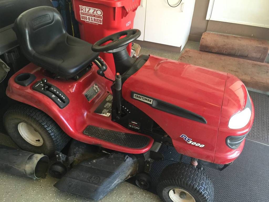

I just purchased a DLT 300 with a junk 18.5 hp briggs intek engine. I found a 22 hp intek engine that I would like to swap in. What if any issues will I have?
#2 ·
I think the 22 only came in a twin. You'll need the muffler unless you want to do some fabrication. It's always a good idea to get the pulley with an engine also.
The six pin harness may very well be plug-and-play but it's always best to see where the wires go and make sure they are right before you plug it in and risk getting it wrong.
It's almost a shame to put a 22 V-Twin on that tractor which is probably a 42 maybe 48 inch cut when a single 17 - 20.5 works just fine. You will notice you will have tons of power though. It will no longer bog down in heavier grass it will just cut through anything. I have owned about 20 of the green Craftsmans and some of the gray and red ones afterwards. For a long time I had only had the overhead valve 14-19. 5 or so horsepower singles. When I came along my first horizontally opposed twin 18 or 19 I was amazed how it would go through any grass and not even slow down.
You will use more fuel though. Don't try to running at a slower than normal operating speed. Not good for cooling or on the engine at all. Since you are re-powering and the throttle has been messed with you should actually get a tach and set the RPM to the correct for the model of engine.
Many of those are 41xxxx engines and are supposed to be running 3450 to 3500 RPMs.
