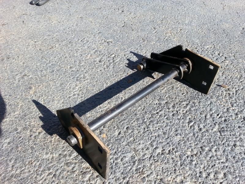

I'm sure this is a silly question, but one I do not know the answer to. I am putting a Click-N-Go attachment bracket on my 445, and I think that the current attachment needs to go, but what is it? and what is it for. It connects to the rear hydraulic cylinder, but not sure what it is used for. Anyone using the quick connect on their 445? Thanks.

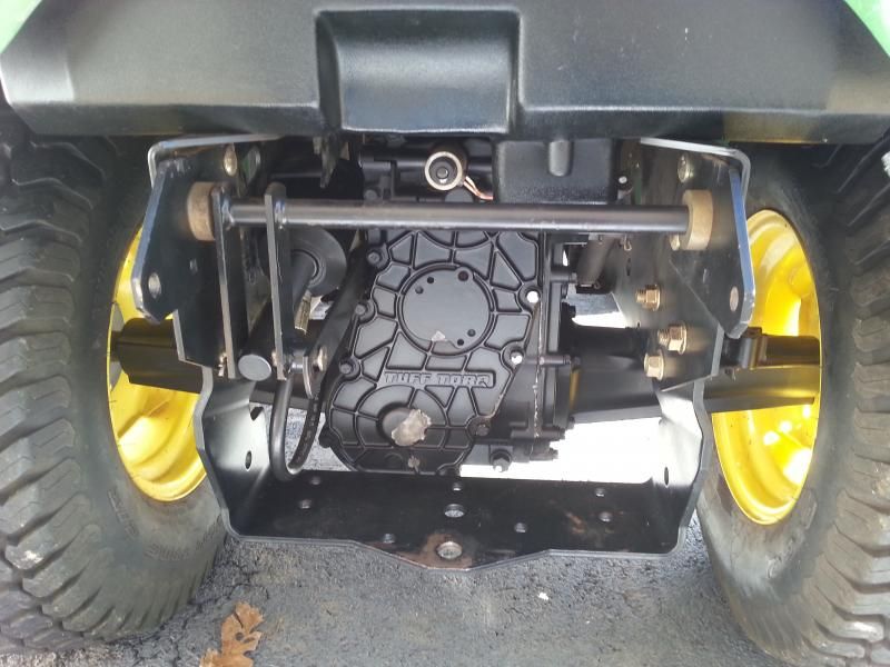

The rockshaft has to stay on tractor or mower deck will never lift, the click and go will be on outside of frame
#7 ·
you might have to take your click and go off for a second to reinstall rockshaft assembly then reinstall click and go.
#8 ·
I got everything in place, and other than the c-lock washers, everything appears to be good to go. Thanks! I would been scratching my head in the spring wondering what was wrong with my deck lift.:sidelaugh Still learning how the everything works and works together, but I've got to say other than looking stupid occasionally, I'm having a blast with my new toy. Now, I can't wait to really use it. Used the blade on a couple of inches of snow, other than that not much, yet....
