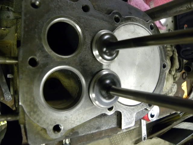

The motor used some oil so it has been the main issue. It was stripped down and cleaned thoroughly in our shop's hot vat.
The head was decked .060" on our mill and cc'd at 46cc creating a 10:1 compression ratio. The cylinder was honed out and a new .010" over piston fitted. Since rings are rare as hens teeth for this thing, I went to our Hastings book and found that rings from a 1955 Lincoln V-8 are an exact match, so a set was ordered in .020" over and end gapped accordingly. The valve seats were given a 3 angle job and the valves had the faces resurfaced.
