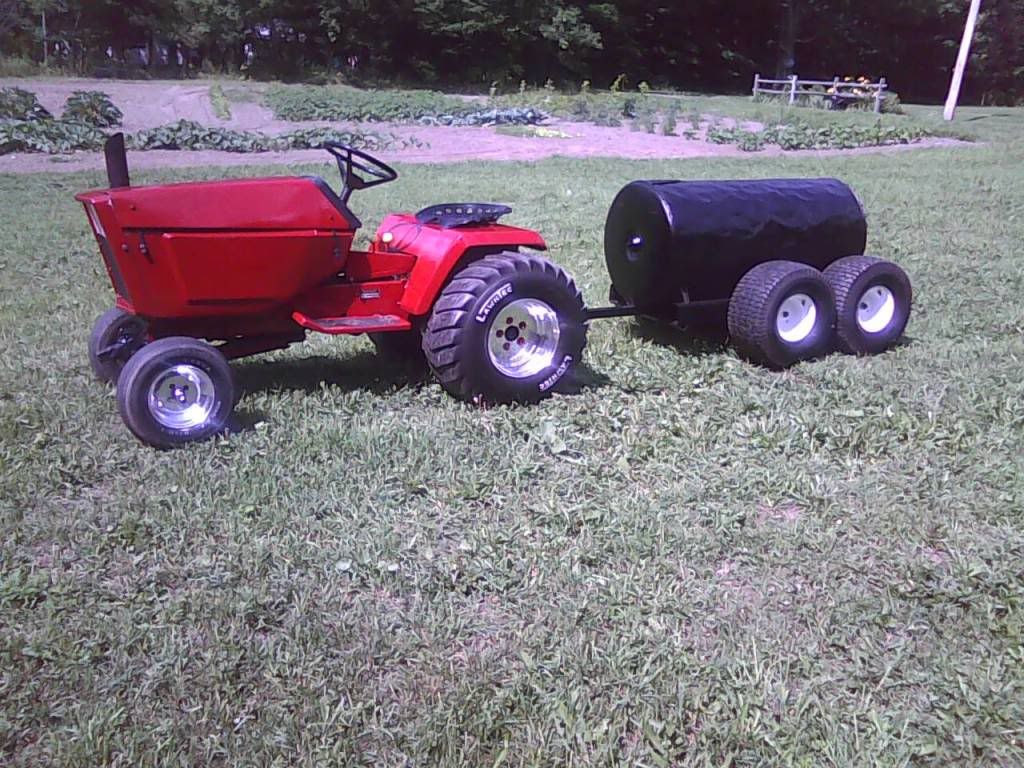

hi all, had sum time so thought id post sum pics of my diesel project.

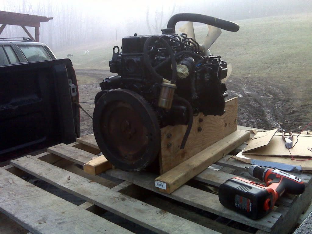

this is the diesel engine in back of my truck after i got it home. Its a 3 cylinder mitsubishi 22hp out of a rice combine i was told.
these are the mounting brackets i made from sum 1/4 inch angle i had.
motor in place, and bracket put in front for the battery.

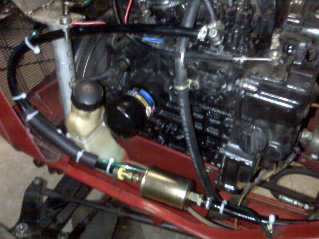

this is a gocart radiator got off e bay.
radiator mounted.
fuell lines run with a chevy gas filter.
electric fuel pump put in.

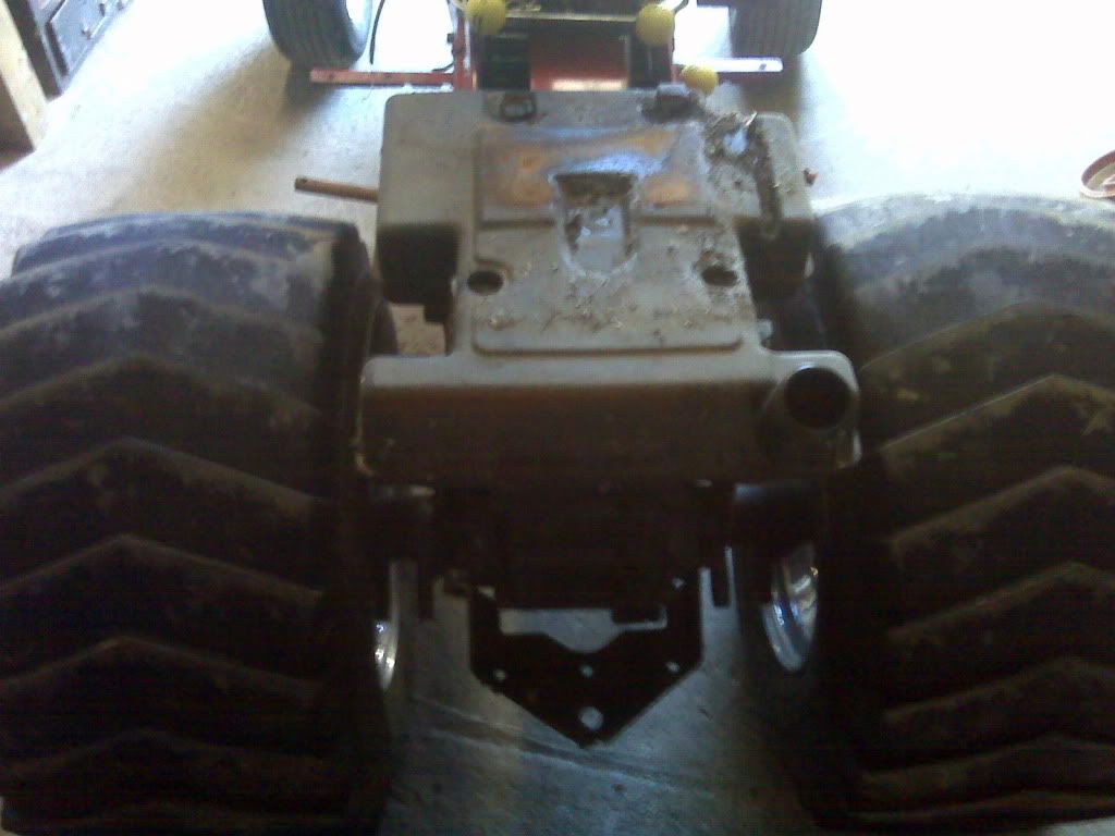

this is a gas tank off a sears im useing
this is finished product, sorry i didnt have more pics but i did this before i joined this forum. I made a driveshaft from a steering shaft out of a mack truck, finished up with wireing and paint. hope you enjoy

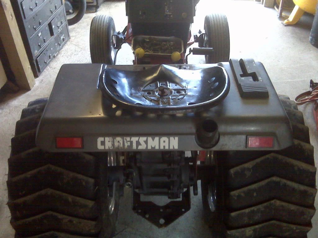

Why the steel seat and craftman rear fender?
Discussion starter · #8 ·
hi all, thanks for the replies. the rearend is outa of a old ford lg 14 hydro. has far has the craftsman fenders, i needed a rear postion fuel tank to have enuff room under the hood for radiator and battery and airfliter, so i put the sears tank on, and fenders were already made to fit the tank so i figured it was just easier to use the fenders. the steal seat is just a personal preference for me[touch of ol school i guess] i plumed into the rearend for live hydrolics to run the front cylinder and another out the back to run the sleeve hitch, my tiller,and dump trailer.
