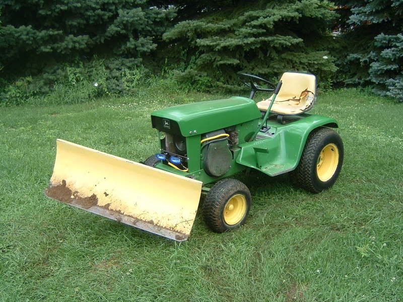

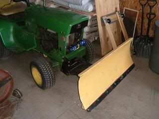

I built These so my wife could clean out the horse barn; All aluminum parts except the cylinders; Total shipping weight 127lbs; Lifting capacity 750lbs, Made for 300 series And 425/445/455/series Hook up to stock hydraulics.They were a fun project,
