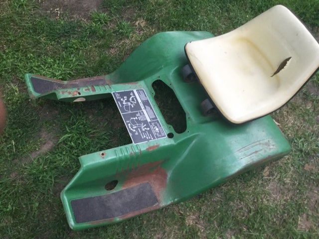

Got home & checked them out, with the 212 I found a fan blade sitting on top of the deck, then 2 blocks of wood in the battery compartment & a empty quart bottle of Quaker State helping secure the battery!!

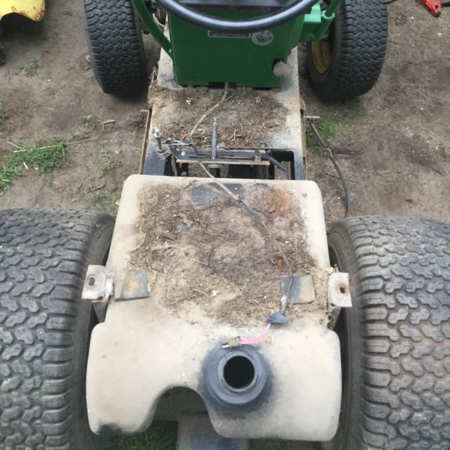

112 is almost complete, missing shield on the right, deck covers & is missing the front grill/headlight bezel.
Not sure of its exact state, but I'm going to play around with it, electrical in it was definitely chopped. I did find a couple wasps nests in it while looking it over, definitely wasn't fun.

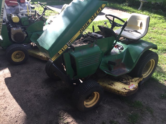

Update time, decks look OK, but not great. Here's the 112, I'll grab a pic of the 212 deck later...

Well I found a solution for the 212, after looking awhile on Craigslist & eBay, I found a 100 series transaxle & everything turned out to be exact!
After 240 miles round trip, looked it over, made sure everything worked, this is what it looks like.
Had to transfer my shifter handle over, & brake but was definitely worth it!
Now to fix up the 212's deck & it should be a running/mowing machine.
