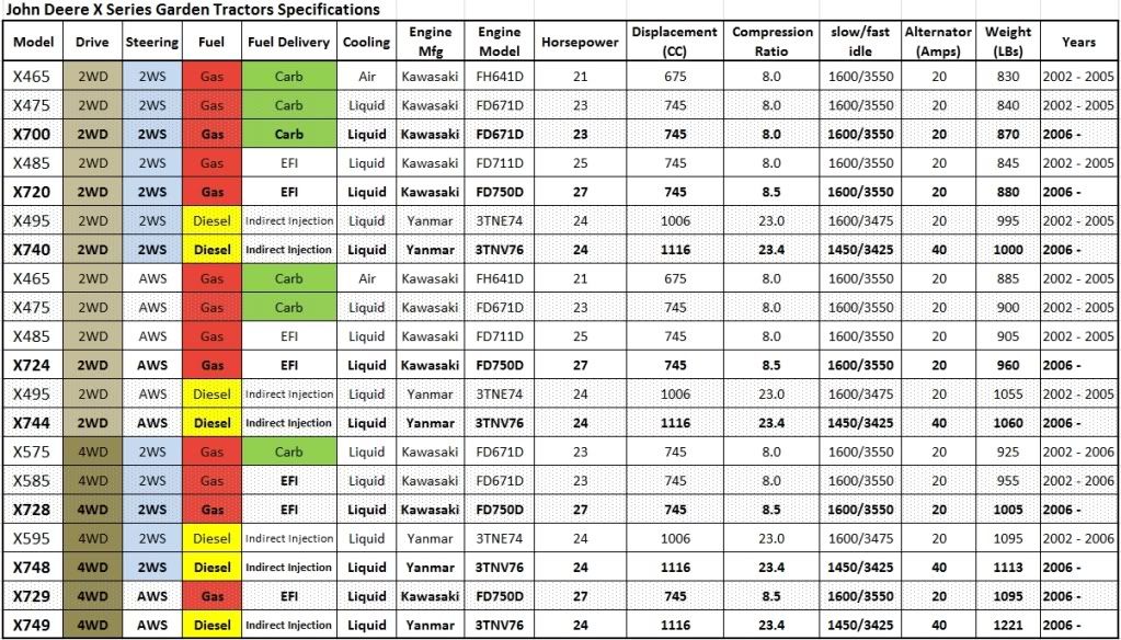

Here is a 1st attempt at consolidating some of this info. I hope this is not a repeat as it would be a waste of a bit of time... This may help a little with Brett's survey and what the #s mean. I intentionally sorted it this way to try and put like models next to each other instead of an alpha model # sort.
I'm sure it needs some editing.:fing32: Let me know, I'll update it and post an updated image and/or a shared spreadsheet with the info.
Bold are current model tractors.
2011 models not included. Some mid-model engine and other updates not included, ... WMMV:thThumbsU

X485 and X585 are also EFI, btw :)

Great job, but of course someone has to ask for one more column right?
How about me? and how about a column for the transmission? Would that be easy (sure I'm asking for you to do it so it is plenty easy for me to ask) enough for you to collect and add?

I think the X585 was a copy/paste error. I should have know as my last look I said "hmm, that is a lot of carb models" but was distracted by the DVR delayed football game...

I think all of these tractors use a version of the Tuff Torq K92. The manuals I have seen don't show this detail though.
Can anyone confirm this (no new column is needed if they are all the same) or point me to an information source?

One note of correction: I'm pretty sure the X575/585/595 were not AWS models.
To the best of my knowledge, AWS with AWD did not arrive until the X729/X749 with the introduction of the new hydraulic AWD system that eventually replaced the mechanical 4WD on other models as well.
I would also suggest referring to the new system as "AWD" to distinguish it from the earlier mechanical part-time 4WD.

That helps a lot. Ever look at anything too long and then see nothing?
More copy/paste stuff but deleting is easy... :thanku:

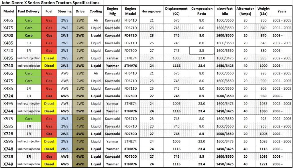

Here is a quick update based on feedback so far.
What sort order makes the most sense? Of course once the spreadsheet is attached you can sort any way you choose to...
Man thats a nice chart! Great info!:fing32:

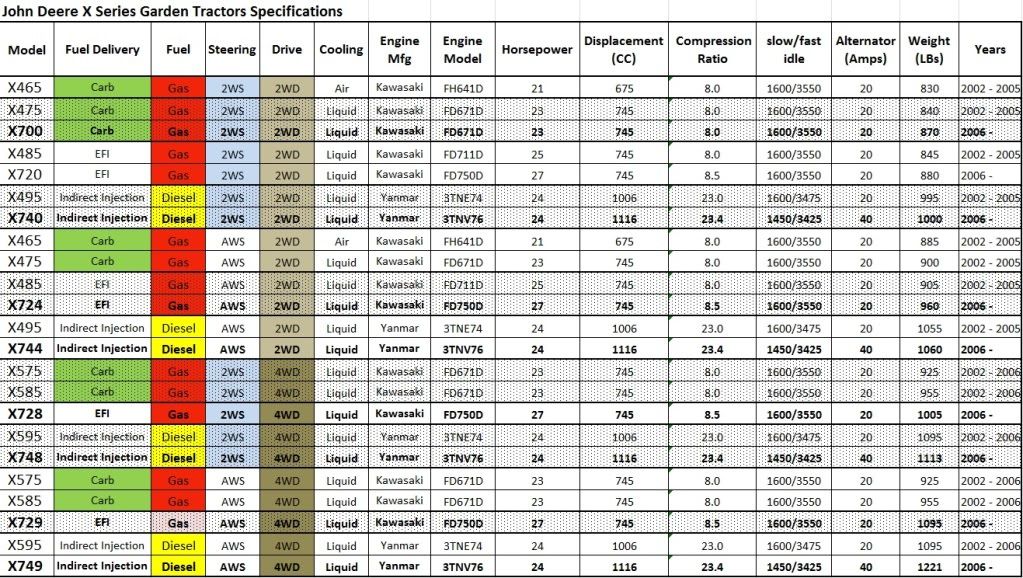

Same data with a correction to bolding and with reordered columns to match the sort. To me it hurts my head less to look at it this way.
and sorted my model for those who want to see it that way.
POENY,
You are the man! One wonders why JD doesn't make the info available like this?
Forgive the nitpick, but X729 and X749 came out a couple years later than the other X7s. I think their first model year was 2008 -- maybe somebody can confirm?
Also, I added a note to my previous post, where I suggested calling the X729/749 drive system "AWD" (for full-time All-Wheel-Drive) rather than 4WD, since that was a fairly significant change to the drive system.
