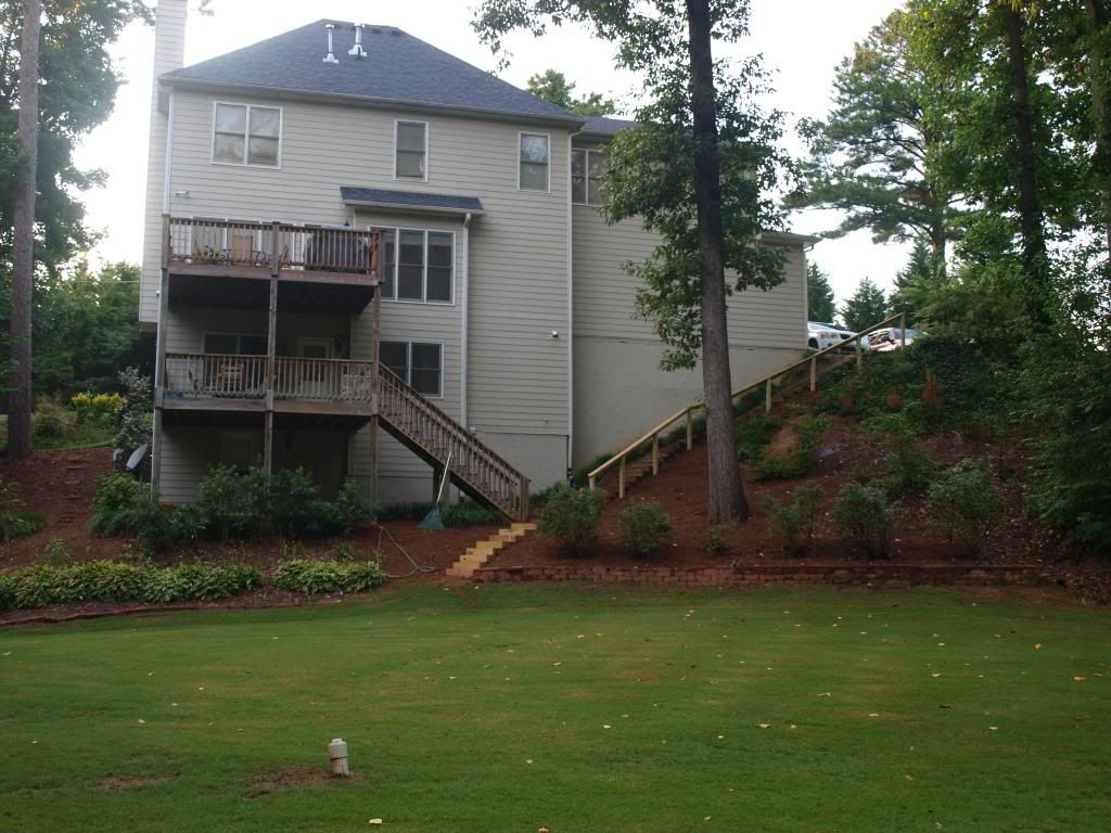

A 30% grade for 200' is about a 50'- 55' rise taking transition from flat to slope into consideration. How tall is your house? The average bungalo with a 4/12 pitch roof is about 18' tall. Add 9' for each additional floor.
It's four stories total. Two to the street level. It's not quite as steep as the stairs. The hill is out of frame to the left of the house.
