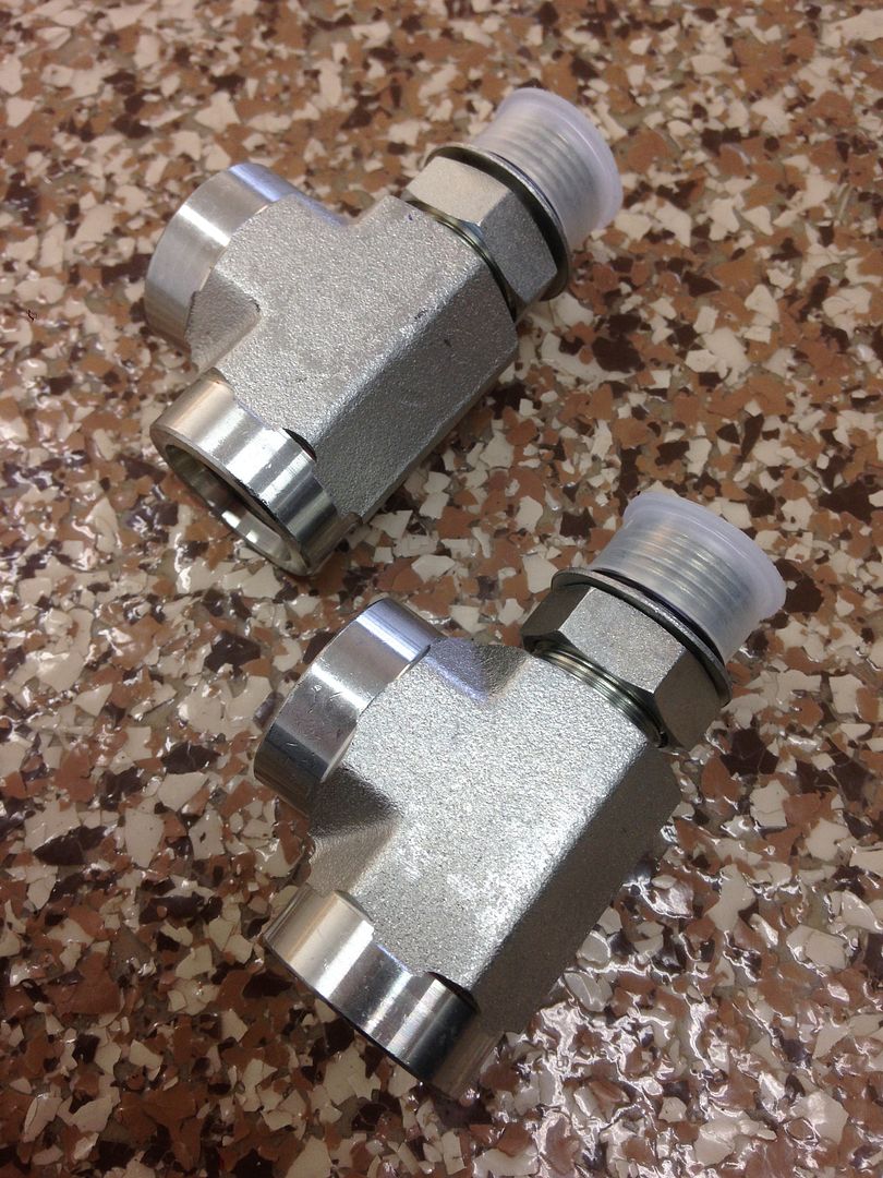

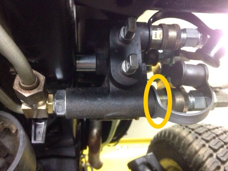

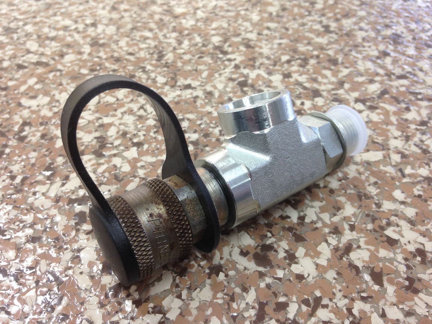

I never did find the right o ring boss x o ring boss x npt or JIC fitting, nothing even close. I know they exist, I just didn't have luck finding one. I ended up using quick connects and using the factory hardware.
The fitting I used is: 8 male boss x 8 female boss x 8 female boss. And the rear hose connection for the top of the T was a 90 with a male boss.
I didnt want the hose with a quick coupler hanging out there until I needed it. I was suprised aux hyd sells it that way.
Honestly the top two valves protruding out further because of the T than the lower two makes hooking the hoses up easier on the loader.
If you guys strike out and Hose and Rubber wont ship them, let me know, I pick some up and mail them. They?re about $13 each.

Jeremy,
Thank you again for the pics & info. I contacted Ron at Auxilliary Hydraulics and he has these exact 'T' fittings in stock. So I ordered a pair to hopefully spur the rest of the project along.
Andreas
"T" fittings received from Auxilliary Hydraulics - exactly what I need. Now I'll look into how I want to set up the remote rear couplers.
Andreas
Good deal. I didnt know they offered the ?T??s they?re not shown in the x series rear hyd kit they offer.

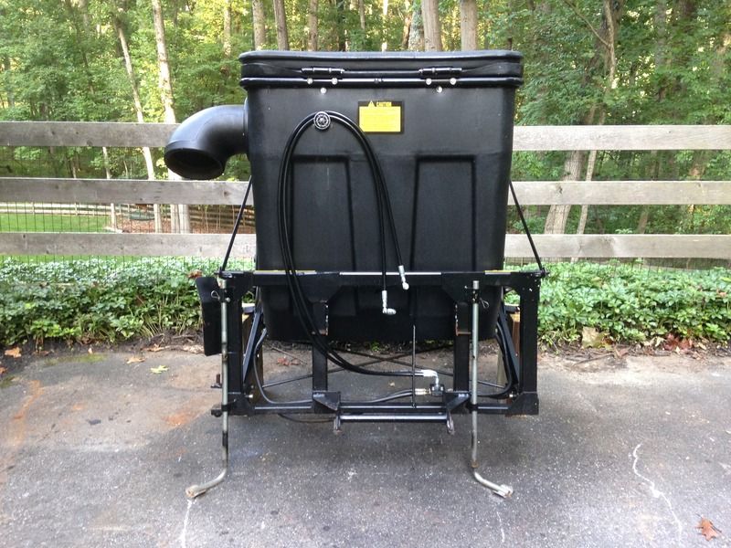

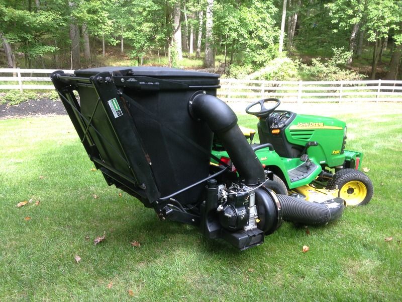

We need pictures of this.
Andreas,
Did you just pick this unit up? It looks brand new!
Having rear hydraulics definitely opens the door to so many possibilities.
Roger
Andreas,
Roger,
No, I clean it after every leaf season, hose it down with WD-40, and then cover it till next near. It's about 17 years old and I purchased it a few years ago.
Andreas
