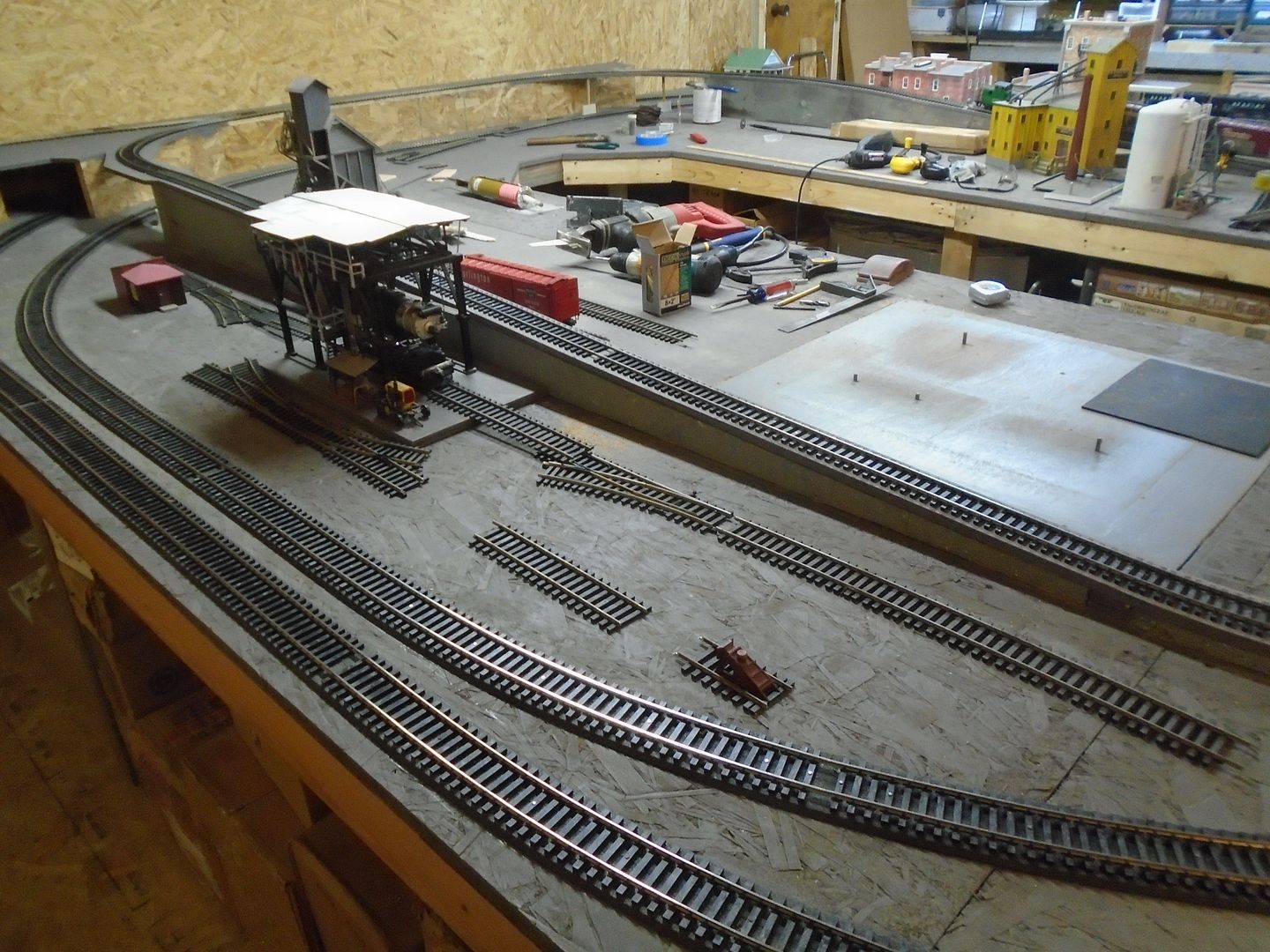

Now that I have the three main tracks all laid down and working properly, I'm starting to figure out where I want the buildings to go and how to run the track to the ones that need rail access.
I had hoped to have room for my turntable and a rail yard.
Unfortunately, there isn't room for either of those so I'm trying to make the best use of the space that I do have.
At the back of the layout, I have cut into the second main track and I'm going to put in a turnout switch and there will be two more switches coming off this first switch.
The straight thru track on the second switch will go under the bridge and around to a railroad maintenance area on the other side of the track that climbs up to the upper level.
This Orange Mountain Mill will sit in front of this first switch.
This is the only building that I'm using on my layout that I did not build myself.
It has a loading dock that is built on an angle and it will fit perfect along side the turnout switch.
The third switch will come off the turnout on the second switch and the straight track on it will go thru this coal tower.
This is where the coal is dropped from the bottom of the hopper cars and into the storage space under the coal tower.
There is a screw conveyor on the back side of this tower to bring the coal up into the top of the tower.
The turnout on the third switch will run over along side the coal tower so locomotives can pull up there and fill their coal tender with coal from the coal tower.
The track that runs thru the coal tower will continue down to the back side of the Rubber Stamp Factory so liquid rubber can be unloaded from tank cars and pumped up into the two storage tanks.
There is also a loading dock for loading or unloading rail cars.
The factory is mounted on a 2 inch thick base so I had to cut a hole in the table that it can sit down into.
The building has been removed from it's base to make it easier to work with.
With the base sitting down in the hole, the top of it is flush with the top of the table.
Over on the left side of the layout, that track that came straight off the second switch and under the bridge, will run around to this open frame overhead crane area.
This crane is for lifting the boiler off the chassis.
Then the chassis can be pulled back out and pushed around the crane and on into a machine shed for repairs ( I still have to build the machine shed ).
