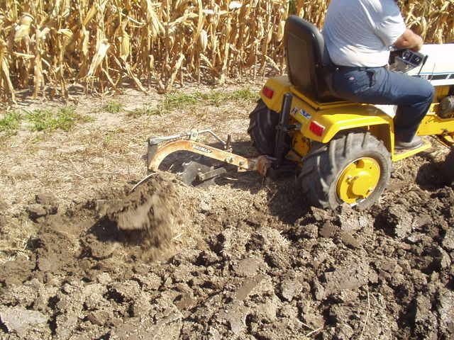

Big horse power isn't the key to plowing....traction and having the plow set right is. You need to have wheel weight(s), fluid in your ag tires or both if want to plow where I live. All of the soil in the links looks like it is a sandy type soil. This is the type of soil I have:
Sometimes I'm lucky enough to go to a plow day that has sandy soil:
This tractor is a 10 horse power IH Cub Cadet pulling a 10 inch wide Brinly plow. The tires have fluid in them. Tractor has only 5 hours on it sice it was restored. Notice how the soil breaks up when turned over. I have 3 graden tractors set up for moldboard plowing. They weigh 750 to 1100 pounds without a driver on them.
