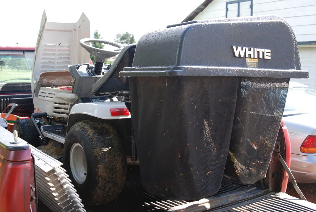

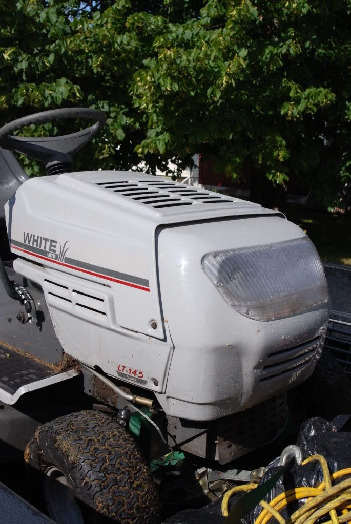

I found this sexy beast for the grand total of $0.00! The previous owner went out to mow this spring and it didn't start, so he went and bought a new mower. He got tired of pushing the White out of his garage, so I genourously helped him solve his problem. My wife is at work and my toddler is too inquizitive to help me work on it now, so I am pacing with anticipation to get it running. I turned the key and nothing. That is all the previous had done to gt it running as well. If nothing else, I scored a new seat for my 990. At best, I scored another backup mower to fill the shed with.
Pictures are as she sits in the truck:

Well, my wife came home and the rain let up and I failed at my first startup. I know the battery is junk. My charger would only display the fault screen and my voltmeter showed only .1V DC so a new battery will be needed. Now comes the question. Could the battery cause this? I took a set of cables and jumped it(the battery) to my truck and the engine would would crank but very slowly. I would call it a flopping sound. Crank-flop-short pause-crank(more slowly)-flop-longer pause-crank. I had the negative hooked to the frame and the key off, when I took a jumper from the positive to the starter, I got the same slow crank. Any ideas? Thanks, Jimmy
292 Posts
quite possibly the battery as a bad battery will cause many strange problems I once replaced a starter because I could not get mine to start even with jumping it . I ended up replacing the battery and it fired right up with barely touching the key . but could also be the starter is a little tight from sitting take it apart and clean it up and lube it . It will last longer that way to because it will turn more freely and build up less heat

Thanks cowboy, I was going to get a battery this morning either way. Seeing as I know the battery is junk, it is a great place to start. The starter is my next option, but I am hoping the battey will take care of it. The preious owner never tried to get it running. The battery under the seat has seen at least 9 years of sitting through WI winters and the guy went and bought a new machine becuase this one "wouldn't start".

VICTORY! A $20 battery fixed the problem and it started right up, ran mowed and bagged like new. Of course I got the, "what are you planing to do with all of these tractors?" speach from my wife again, but that's to be expected. I am going to pull out my pressure washer later and give it a bath and then start thinking about down sizing the herd. My mowing duty wheel horse might be sold off to get me a new toy(box scraper) for the 990.
