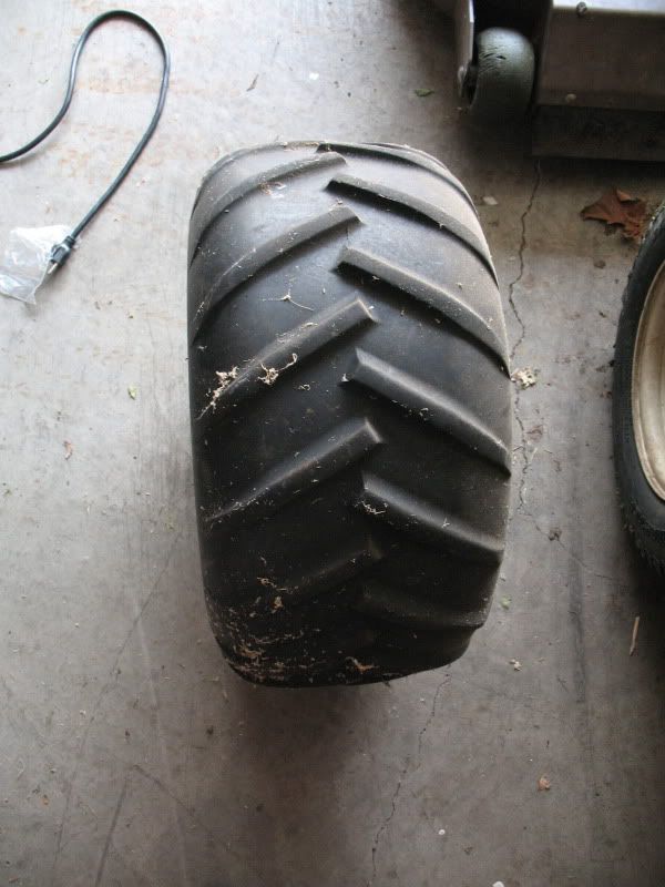

I mow 10 acres for the school district (elementary grounds) we have two Grasshopper 928D ZTR mowers. The grounds man at the High school likes to run the paddle tires on the turf but I prefer to use the turf tires and then switch to the paddle tires in winter because the chains go over the paddle tires easier. I do admit that the tread does clog when the ground is moist causing slippage. Perhaps I should try the paddles on the turf?
The biggest problem with these mowers is they produce a tremendous amount of torque and the wheels spin sometimes and I don't even realize it. This action damages the turf.
Which tires do you folks think I should be running on the turf?

I think that with either tire, these beasts have the potential to do some serious turf damage if turned too sharply.
FWIW, the Ag lugs on my GT (liquid filled) do not mar my lawn.
Most guys i know that run Grass hoppers run ag (bar) tires on them. They claim they get less tear out when turning, plus better traction on wet grass.
I'd go with the ag's as well, they clean themselves better. Those you picture have rounded off lugs at the edge of the tire and shouldn't tear the turf too badly in turns.
Raise your 0-60 time a little bit, also, to lessen the wheelspin.:)
Those ags look a lot bigger than the turf tires. Are they compatible?
Driving style, as mentioned has a lot to do with it. Wheel spin with turfs can do more damage than ags but a lot of really tight turns with ags can do more damage than turfs.
I bet you will find that the AG tires slip LESS with the tourque of the mower. I have a lot of places where I used to scuff the grass with turffs, and not with ag's
Thanks for the input. I think I'll give the "ags" a try this summer.
