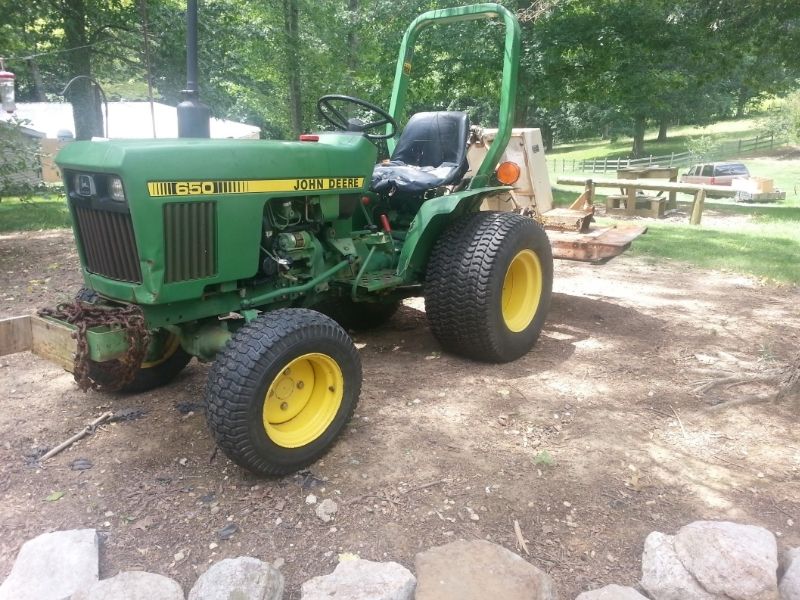

I REALLY expected an issue with the 2,000+ pound machine I just picked up :dunno:
15.5 inch wide tires pushing the grass down, RIGHT in front of the mower,,, :swow:
There was a slight issue of uneven cutting,,,, where the grass had received PLENTY of fertilizer,,,
but,
where there was normal or little fertilizer, the mower cut perfectly flat.
So, it may be the rain, and grass feeding,,, causing FAST growth.
