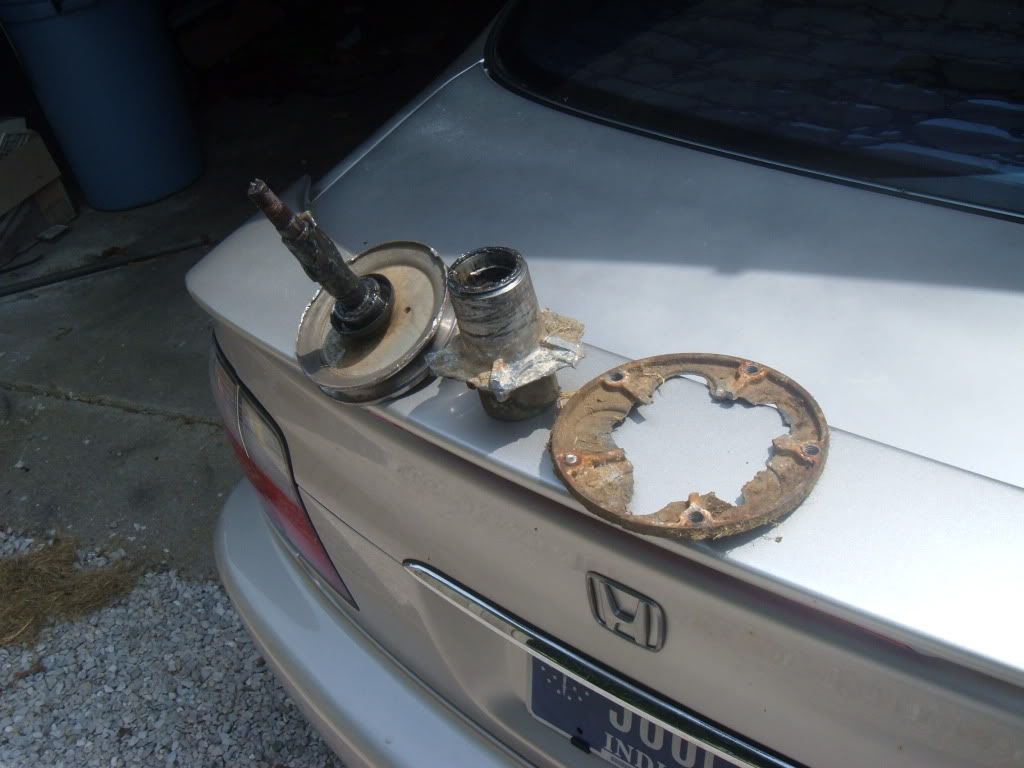

So I broke this last week and figured I'd better get on it so I can cut the lawn. I tried to look at the parts list for my mower(425015x92) but the murray site says it cannot find it. I thought it was a called a mandrel holder as the pictures I find on the net call it, but one guy told me it's a jack shaft? Another said it's a pulley cap? Would I need to find this whole assem. or just the piece I broke? Any good internet stores with good prices anyone can name?

You need a Spindle Assembly. Some refer to it as a Quill Assembly. That one looks to be pretty well shot.

You need quill assembly #1001200ma. That will not include the parts to the far left, which is the jackshaft and belt pulley. Jacks or Willards small engines are good sources for Murray parts.

That quill didn't break like that in use did it? Scary if it did. I'm assuming there was a hammer involved lol.

Thanks for the help guys. Thanks for the part # BushBone. Yes, it happened in use, sounded awful. I already had my hand on the lever at the time. Discovered there was a block mostly buried in my backyard. My old mower never touched it. Recently conducted a sweep of the yard for anymore of these.

The jackshaft should be ok as long as it was not thrown out of true by the impact. The part itself is about $10.00 but can be a bear to get the pulley off of it.

As bad as that one hit, I'd just buy a whole assembly, and be done with it.

Yeah, that was a violent hit. Good news though, I just rechecked the part and the jackshaft is included with the new mandrel. $25 at this supplier, though I've never used them.
