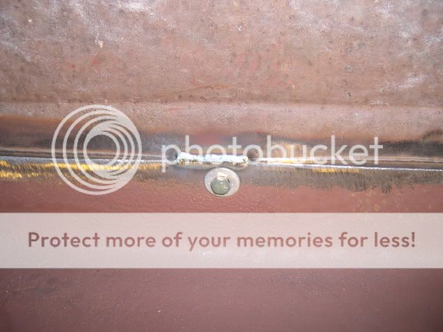

Almost the last of the salvaged bilco cellar door being used on a friends project. http://www.mytractorforum.com/showthread.php?t=144579
1st step was to tie the bottom and the sides together, I prep them, and my son welds...turning on the cooling fan and enjoying himself. :fing32:

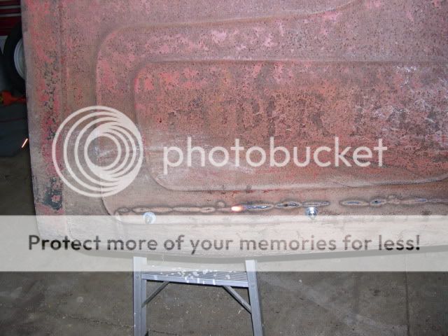

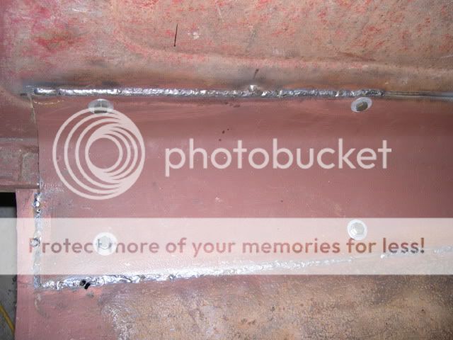

2nd step. Complete the front and the corners. Help a friend that helps you.

The last pic in the first post is pretty cool, you can see the heat of the weld glowing. I figure that was taken while it was being welded.

Are you using flux core or gas?
We're using co2 gas and .035 wire.
It's good to see the melding between two pieces of old metal. Both sides were cleaned as best as posible before welding.
Here is a single downhill mig pass on the scoop.

Maybe you're using what you have available, but I think you'll get better looking and stronger welds using 75/25 argon C02 mix.
JMHO,

I agree with a 75/25 mix.
That was why I asked which you were using.
But if you had a fan on you might also turn up your gas pressure.
Are you going to do another pass over that one?
The right side seems to need filling in from what I can see.
Mike we've been using only co2 in this machine for 29 years I guess I'm in a rut. I will try the mix on the next tank, what is the cost difference?
Dave, the only fan that was on was the welders own cooling fan. Yes more weld was added as necessary. :praying:

need to really shine that weld area up when using mig.
Yes I agree about clean metal bonds best. It was tough on sections where the metal was pitted from age. I ground it bright, wire wheeled and blew it off but I think one section justified using the sand blaster.
