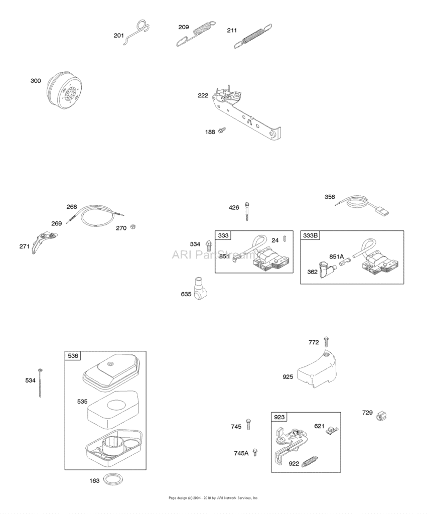

its a briggs 450 series
M 09s502
T 1019b1
C 08103152
part 209 hooks to part 222 somehow, and i dont know how, i hope someone has one and can take a pic of the set up, im fixin it for an older neighbor, she got the spring cought on an azalea and it ripped it off so i have nothing to base it on

Sorry man. That's a Briggs & Stratton "Classic" series engine. I was working on one a month ago, but it's gone now. Which spring is the #209 spring? And what about the #211 spring. One should be the governor spring. The other one, I'm not sure.
What's on the engine now? Is the governor spring on the engine now?

i found one today on a mower at wally world
now i can put this one on, i have the right spring (209) it hook to the very middle of the speed control lever on part #222,
