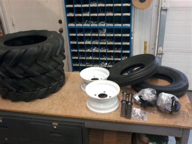

I've been putting plenty of hours on this ol' workhorse since my diesel swap and have been VERY pleased on the whole. However, there's always room for improvement! One area of concern was the steering; years of use had worn heavy grooves, causing the already lacking steering to become quite cumbersome, especially with a plow/blower hanging off the front. I decided I'd like to do the thrust washer/needle bearing mod (so graciously outlined on this site) and run tri ribs. I wasn't entirely sold on the 6.5 wide tri ribs that would fit my stock rims, so why not upgrade everything... lol
I could have bought the 6.5s for $140ish; instead I picked up 4.0s from GCT and then hopped on to eTrailer for some 3.75x8 4 bolt rims and 1000lb 4on4 hub assemblies and spindles (standard 2000lb trailer stuff); total cost was about $150. Of course while I was ordering things, I went ahead and grabbed some 23x8.5 Deestone Ags. They may not be the greatest, but they'll suit my needs fine!
Now, on to the fun!
I do love a fresh pile of parts.
