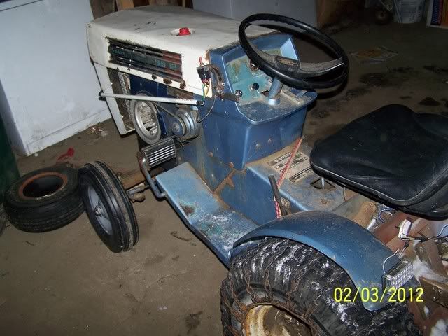

Not sure if I made the right move or not, but ended up buying a pair of Tractor Supply wheelbarrow rims w/ tires today. They were on sale, so I convinced myself I had to buy them - $10 per tire/rim. Usually they run for about $20 each. I needed a way to mount the deestone tri ribs I have onto the sears, and make it quickly changeable back to the 16-6.5-8 rims for summer mowing. I needed a second set of rims - I have a set of rims that the deestones would fit, but they have different bores and are too long to fit the sears spindles. I would have to make two different spindles from scratch, and I really didn't care for that idea.
Anyway, I opted for the TSC wheelbarrow setup for a couple reasons:
1) Quick and easy way to get my deestones going so I can try them
2) Bearings were right size, and the bore length was small enough to fit on the stock sears spindle. Just need a washer to shim the space between the bearing and roll pin
I realize these rims are probably too flimsy for what I want, but it's not like I have a loader or anything overly heavy on the front. I figured its at least worth a try :thThumbsU

I'm not too worried about the paint yet - hopefully everything on the tractor will get painted this summer, so if the paint on the rims last that long, I'll be happy. Not sure if this "restoration" goal is realistic though - summer always seems to fly by. I bent both rims in a couple places, but nothing that couldn't easily be bent back and fixed. Tires will be fine as the beads are thick. Thanks for the reassurance guys!
Got both the tires on their rims, and put them on the tractor - the right front rim wobbles a little, but I don't feel like putting it back to original and returning it. I don't think it's bad enough to bother anything, but we'll see how it goes. The steering difference is tremendous! I couldn't turn before with the 16-6.5-6 tires, but now these tires actually track in the snow. Should make a big difference for plowing.

Just got pics:
