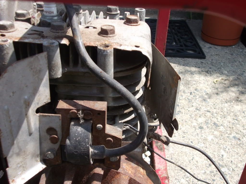

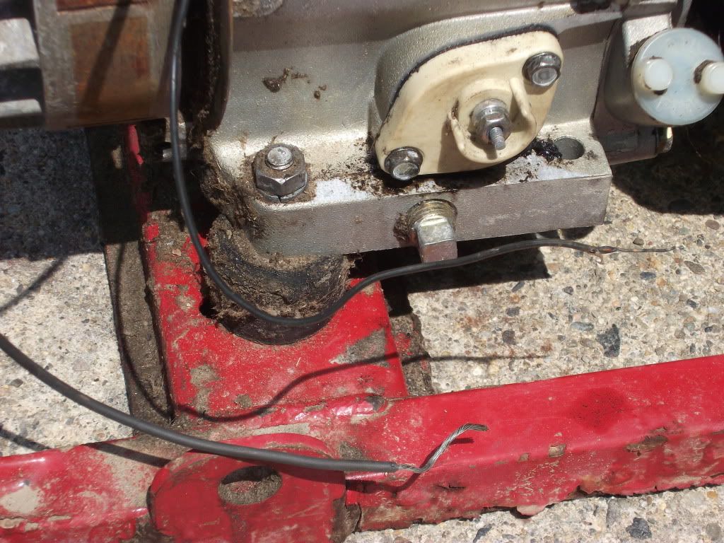

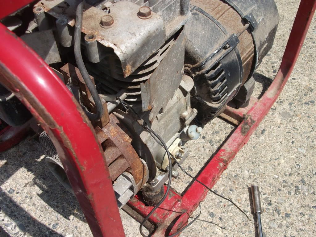

There are 2 wires coming down out of a connector that is plugged into the coil, the other ends look like they came out of what I believe is the "crank sensor". I could understand 1 wire going down to the crank sensor but why are there 2 wires coming out of the plug that attaches to the coil, I think one would go to the crank sensor- where would the other one go? maybe to the "run-stop switch?
Here is the coil and you can see the 2 wires coming out of the plug from the right
Here are the ends of the 2 wires, I believe at least 1 goes to that crank sensor but where would the other one go to?
Front cover that covers the coil
Any Ideas?
27 Posts
What you are calling a crank sensor is the low oil shutdown switch.
Both of those wires from the coil are kill wires.
One to low oil.
One to off/on switch.
Motor should run with both of them hooked to nothing.

That is a low oil shut off switch,one "kill" wire will go from it to the coil,(one of the two on the plug on it ) and the other probably went to the remote throttle/shut off controls..the "crank sensor" is built into the coil,its thart lump on one side next to one of the armature legs..
