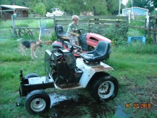

Well, I finally got to get started on my GT6000.

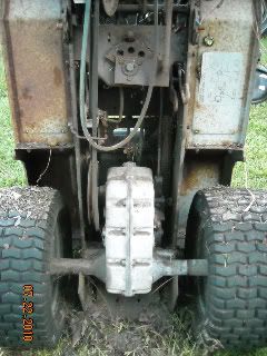

I'm curious about the transaxle. Can anyone point me in the right direction to ID make, model, and specs? All I know for sure is its 3 speed with hi and low range for a total of 6 speeds
The tractor is a model 917.255933
There's a few more pics in the "rebuild" forum

The transaxle is very similar to the ones in older Suburbans & Customs..no one seems to take credit for building it,Roper may have made it for their own tractors,or maybe it was farmed out to another company for Sears..at any rate its a rugged tranny,some 4wd truck transfer cases aren't much bigger!..
60 Posts
Well good to hear it's heavy duty. When this one is running it will take the load off the Scott's, which we overwork 1/2 the time, especially plowing the garden
