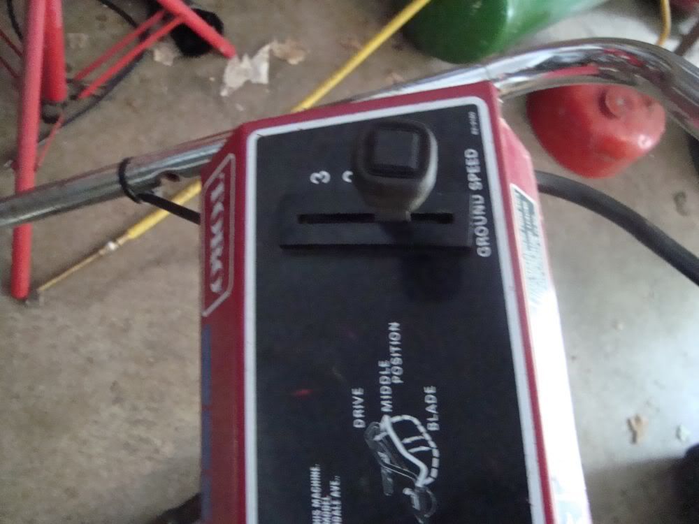

I have a Toro Recycler #20106 1991 model.
Question is how do I remove the throttle handle as it appears the throttle cable is connected to the lever
Drive activator doesn't move so it needs a new cable
Thank You

The bolt at the transmission needs to come out of the pinch harness, then you should be able to get the z end of the cable out of the white plastic gear selector on the trans. Then you should be able to get the selector and cable out of the handle assy.
Shouldn't take too much lube to break the cable loose......
If you need any more help, just ask.
Squeeze the tabs underneath and push up. Simple as that.
