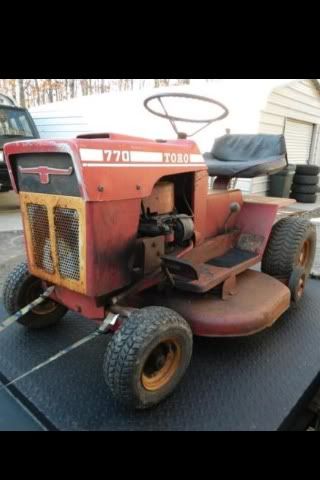

Actually Garry it came with the original owners manual and this cool electric trimmer attachment -
:D I really like it, weather is gonna be decent this week i'll finally have a chance to work on it. I haven't even gotten around to taking it off the trailer yet.

Today I
- Gave it an oil change
- Have taken the carb apart and am cleaning it
- Took the throttle cable off and am letting it soak to un seize it
- Took the muffler off and cleaned out the dirt dobler nest and re - installed it
Hoping to get it running tomorrow :thThumbsU

After your picture was posted I continued the hunt for info on these Toro models that I know nothing about. The 770 at Toro is named a 32" Lawn Tractor. Found many manuals for others also. Now have 123 entries for the tractors and their attachments in the Database Table.
Garry

Very cool, thanks Garry :thThumbsU
So i'm having a lil bit of a problem, it's not getting spark. I've filed the points, electrical checks out, still nothing :banghead3
Maybe it needs a new condenser, or???
