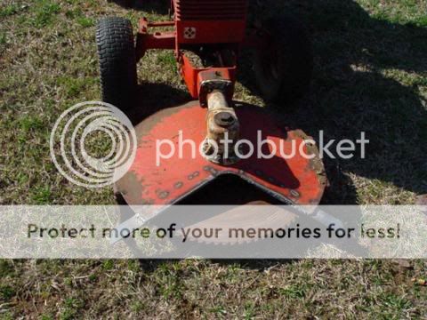

I am thinking about adding another Bush Hog [Brush Hawg, Bushwacker - whatever] attachment and was wondering what to look for [and what to avoid] in older 1950s/1960s/1970s-era units.
Are there some bad models that you want to steer away from, and, if so, then how do you recognize them?
Ultimately I would like to "mod" the unit, so that it would be able to take one of the really large saw blades.
Something like these:
Thanks!

I too have one of the original saw blades and drives but instead will use the 28" saw on the 106 or QH drives. Deck will be modified to have a wedge cut out like in photo one of NBS's but with angle iron on top to reinforce the V. Plus if someone has to have an original unit, I can get another. Gravely sold the guards for the early and 106 drives as an option.
