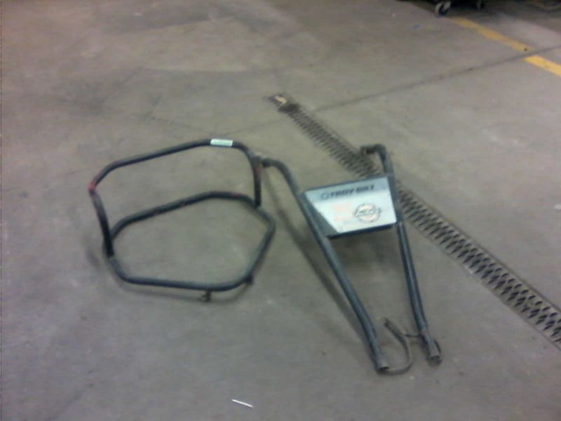

Well I got my black horse home this weekend only one I have ever seen up this way I think
She is all a part and I mean all apart including the two gearboxes which will be a challenge for me to get back together but I will with the right drawings
The guy that had it intended to do it exactly as it was originally supplied so the parts he finished are as new all bead blasted, primed and professionally sprayed with automotive paint and I will have to do the same I guess with what is not done and that will be costly for me. From looking at the gearbox gears etc I think that was the only reason they were totally stripped down for cleaning and paint
I think I have all of the main parts but will be buying most bearings, seals, fasteners, gaskets and shims
Will probally start it in the fall
I was also wrong when I posted her serial number earlier it is actually 2399 with the al tag that says Dean Leith jr silver anniversary signature Model # 2399
Cheers

On the black horse
Stainless motor mount pins and tapped for grease fittings there
All the painted parts were bare metal just painted black except the bumper guard was red and they sprayed the black over it
The cover over the tines is a different profile stamping and the rims are factory drilled for wheel weights which I don't think is standard on others of this year
That is it so far

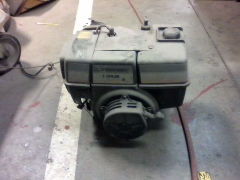

Thanks for the information is is greatly appreciated. On the black horse from a quick inspection I agree 100% it seems just to be paint and decals with a few extras.
There is a black hiller in the batch and a set of plastic wheel weights so now I know for sure what machine they are for
The u-haul now seems to be a lot more than paint. I have never lifted a engine of that size so light in fact I almost dropped the first one after taking the kolar to the truck first I was expecting a lot of weight and there was almost nothing
I will list what I have seen so far on the u-haul below
