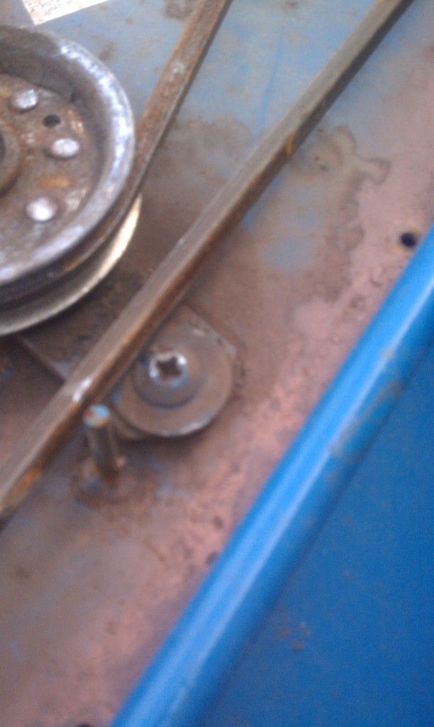

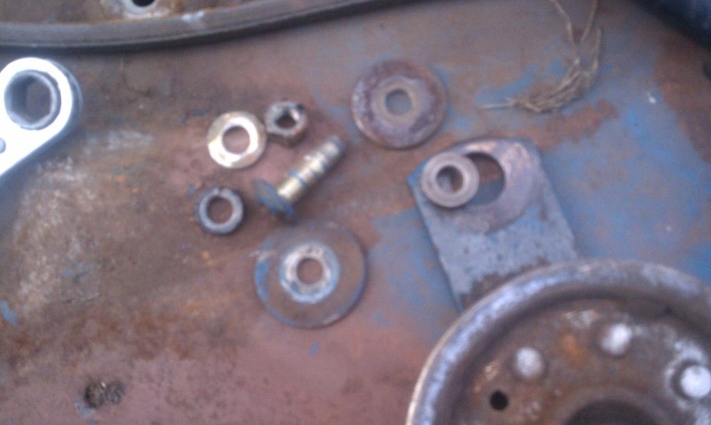

Pictures are worth a thousand words , the bushing must be free.;)
Thanks a bunch Sky, Really didn't expect you to take yours apart, Goes to show the members support for each other here. Must have been the heat from the PO running the deck with the failed bearing that caused the bushing to be seased.
I will finish pushing the bushing off and stop at Fastenal tomorrow to see if they can come up with a round head bolt, self lock nut and a bushing.
In you opnion, is the bushing brass or steel, Mine seems like steel.
Got the bushing out, yes it's steel. Now for a stop at Fastenal, Really appreciate the help with this. :fing32:
Yes, it took 1-1/2 beers before it finnaly came out, and I layed the parts out in the same pattern as you. I still can't tell in your picture if the bolt is fully threaded, or just the end.
Fully threaded, the bushing gets clamped tightly and had just enough clearance to allow free movement . One of my decks had a regular bolt in it with no issues.
I now have a "less expensive" plan. The bushing is free, a little dremel sanding and the bushing now fits in the idler arm and has movement, I have a replacement bolt. Wooo Hooo, Love it when a plan comes together.
Thanks Keith, Looks like this will work. I got hung up on the froze bushing, now it all makes sense, and easily fixable.
