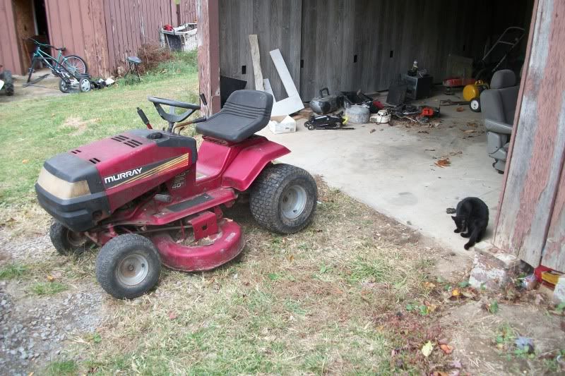

As promised, some pics.
Still dressed in its work clothes.

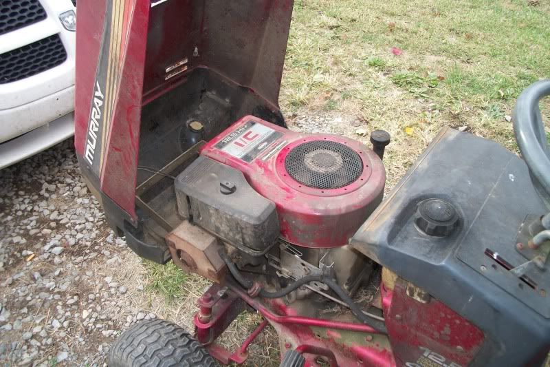

The 12.5 briggs (fairly clean for a 95)

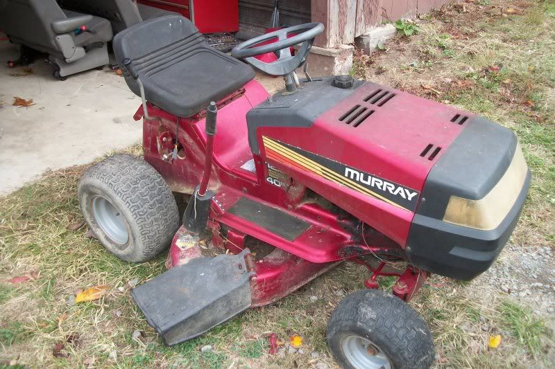

Missing the fender, but the previous owner might have it.

Yesterday we were having very high winds and a tornado warning so i didnt get alot done but heres the "low down" for now...
The owner said it was losing power and finally one day it would no longer start, with the breather off i cranked it & noticed it was pushing air back thru the carb. I pulled the head & it appears the intake valve is not seating & the intake port is crudded up. My valve spring compressor is still packed from when i moved so friday i will dig it out & continue. Other than that the engine is pretty clean inside with very little carbon & the cyl looks to be in good shape also.
The steering is nice & tight and the deck is pretty clean with tight spindles, but whats scaring me is the trans. The spring for the shifter is missing & the shifter is extremly tight & its to the point of flexing before it actually moves. I fear it might be something internal in the trans.
I have friday off so i will be updating then. any questions or comments are welcome. :trink39:
BTW if he doesnt have the fender, would any of you have one for sale?
314 Posts
I just junked out one like that this past March. Kept the engine, tranny, front axle, etc, but tossed all of the body parts. If I still had that stuff, I'd send you a fender.
