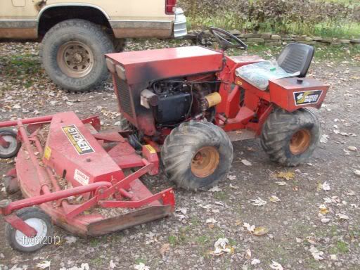

I bought this older Steiner. My plan is to fix it up, give it a paint job then work it. The p.o had said it leaks real bad oil and smokes bad and he only used it to tow cars up his steep incline driveway, He had said the tractor was never under any cover for its hole life just sat in the open. But had said the guy he got it off put a new engine it?
I had bought the tractor it had such a bad oil leak the hole tractor was coated, and had its own smoke cloud that would follow you around.

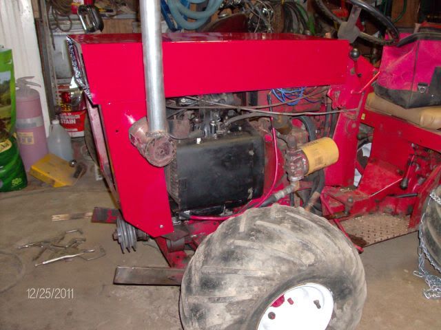

Now i started to give it a paint job, Painting it with Valspar IH red, from TSC. I only painted the hood so far and the wheels.

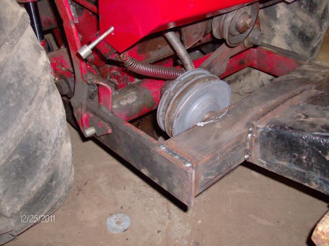

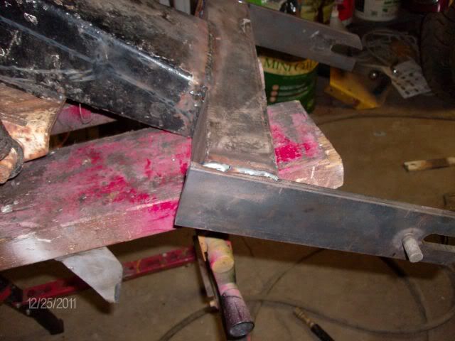

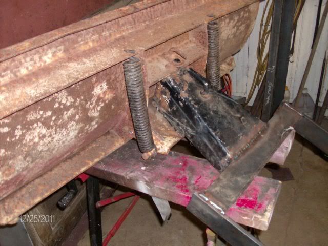

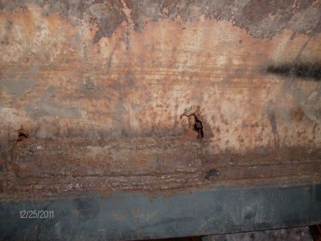

I building a snow blade for it to, i am using a rusted up cub cadet blade. going to cut the wear edge off of it. then weld a newer but longer edge on it then I'm going to put aluminium over the blade part and bolt the two together so i have a smooth blade part.
New fast hitch built for the blade

hood put back on
waiting for the decals to be made, and all that is left to to do is engine tins and front axle area for paint which is going to be a nightmare with all of the hoses and cramped spacing. I need a new camera my old one makes the red look like pink and fuzzy
