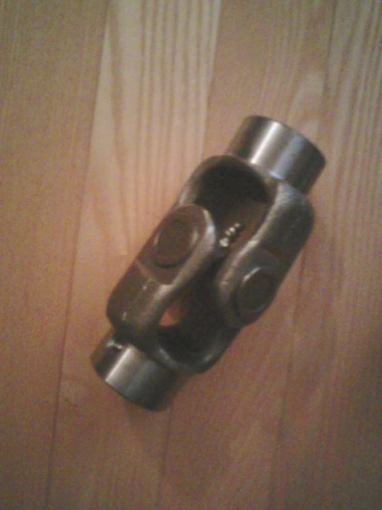

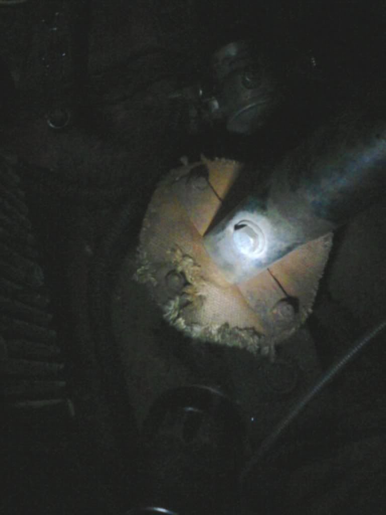

I don't like the rag joint on my machine and I found a rubber replacement online for $7 but I wanted somthing a little better so Im going to put in what i thought about from the start.
Here is the original
Here is the replacement
And I may replace the shaft as well

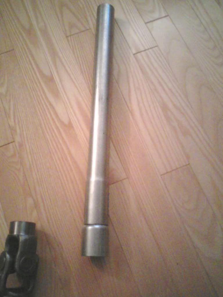

Here comes the pics!!:thThumbsU
Only took about an hour or so. I'm very pleased with the results much better steering indeed. My suicide knob works much better now. It was a little expensive but I had giftcards for xmas for where I got all of the bits and pieces so why not. The u joint was $35, $10 for the shaft( exhaust pipe) $5 for the coupler that conects the u joint to the shaft and $2.50 for the 3/4"bolt.
