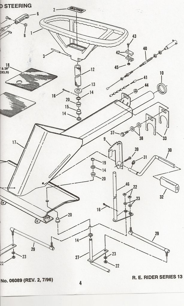

Welcome,to the forum.First of all "SR140",is just an advertising number,doesn't mean much. What we really need is a "model number".you'll need to know the "series" to buy parts,ask us things,and all that look at it well and see if you can find a "tag" with some numbers,not on the engine,that's something you need to know too,but only to find parts for the engine. The correct number should be something like "331415 BE,the 33 is the deck size,the 14 the horsepower,the 15,the series,and the BE would be Briggs engine,with electric start.There are some differences,in the "belt tightening" mechanisms,as you can see from the page from the series 13,parts manual(and yours should be similar),the "square
tube" mowers have a round part where it pivots. This can slide to tighten the belt.then secure the adjustment,a lot use shims,and some dont,and have a "clamp arrangement". if you get into grass,and weeds too heavy the blade can "jam,and the belt will slip,or lock up which usually kills the engine,if the belt is tight. If you think the belt is slipping,get off the "lock pedals" quickly,or the belt can develop "flat spots" which makes it vibrate,or if it slips enough to make a cloud of smoke,it can ruin the belt. I just had to change my belt yesterday,due to the same thing.

Thanks for the reply. I have to leave out now or I would go out and look for the model. Anyway the diagram above is the way it is made. I checked that bolt that the shims were on and it was loose. I need some shims so I will get some for it or make them. Hopefully it didn't do any damage to the belt as it was new. I will need to reset it and try again. I will post a follow up when I do.

The nut #44 is behind the "main case" and don't let the bolt "bottom out",it's a "shoulder bolt" the shims shouldn't be ultra tight,they have to let the tube pivot,the "shim washers help keep the tension right without the tube being restricted.

Sometimes,there are days like that,what's worse is when it's new,LOL. It seems to be a series 11,there are manuals you can download,see the "sticky" on the index page,they're free. I looked at the same page I posted for the 13 and it looks just like the series 11. If you want the "service manual" the "series 4,5,6& later is the latest one available,it's better for the earlier series,but with the parts,and owners,you can usually figure it out.The drive line stuff is pretty much the same for all.
