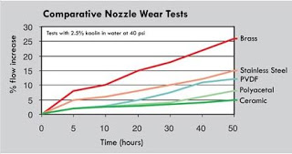

Inaccurate applications due to nozzle wear can waste chemicals and money, making it important to evaluate the nozzle tips. Worn nozzles produce increased flow rates resulting from an increased nozzle orifice area. It is recommended to replace nozzles if the flow rates are 10 percent or more in error.
The nozzle material is a major contributing factor to the rate of nozzle wear. Nozzle tips come in an assortment of materials including nylon, brass, stainless steel, thermoplastic, tungsten carbide and ceramic. Generally, nozzle tips manufactured from nylon or brass will wear out much quicker than ceramic, tungsten carbide and thermoplastic. Thermoplastic nozzles are noted for their resistance to harsh materials, but they are also known to swell with some chemicals. Stainless steel nozzles will typically produce a more uniform pattern over a more extended period of time.
