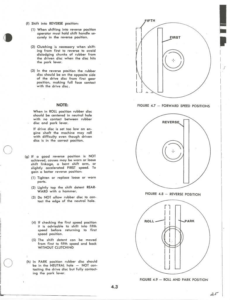

2,453 Posts
Here's an illustration,from the "series 1,2,&3 service manual.This is where the rubber disc should be adjusted to,as suggested by NOVAZ27.Do you still have a "1" speed?
if it's that far off.the rubber disc might be in the center hole(N) in the 1 position
