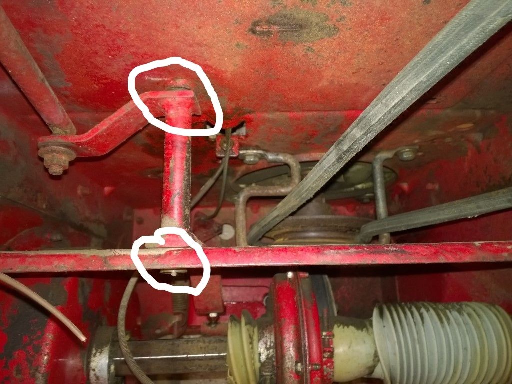

Are the Nylon shift lever bushings replaceable? I'm not seeing them in the parts diagram or the service manual. (but I'm a new guy, and not very smart)

My series 21,doesn't have bushings there,so I looked at earlier series,this illustration,is for series 4&5,this is why you really need to identify the series of your RER. I'm glad to get the info myself,if mine develops "slack" there,I will know there's a bushing ti use.
P.S. I have had mine for 14 years,I've learned a lot working on it,and on this forum.
Wow, amazing. Thanks for the tip and the diagram. My series 14 has them installed but not in the parts list/diagram. I'll order some spares and see if my series 11 needs them as well.
As far as I can tell from parts lists,they were used from series3 to 10,but who knows?
