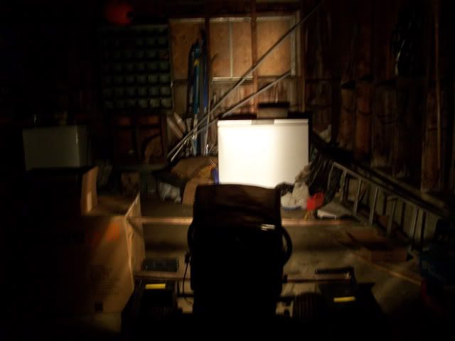

Installed the lights that were ordered from harbor freight, they fit perfectly! They are very bright, and I will post pictures of them in a few days when I get a better internet connection. Very easy to install - took the lamp assembly out of the rubber housing, and mounted it where the PAR36's would have gone, and they fit almost perfectly. The lamp assemblies are slightly smaller than the PAR36's, but still fit fine. Very glad I went this route.
Doug
Photos are now uploaded. Here is one:

Very happy with the outcome of this experiment. Definitely worth doing!
