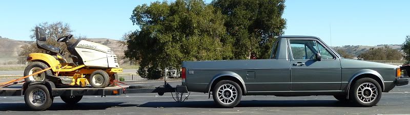

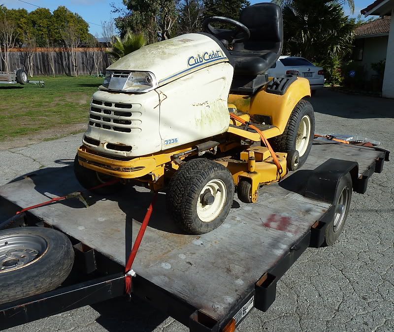

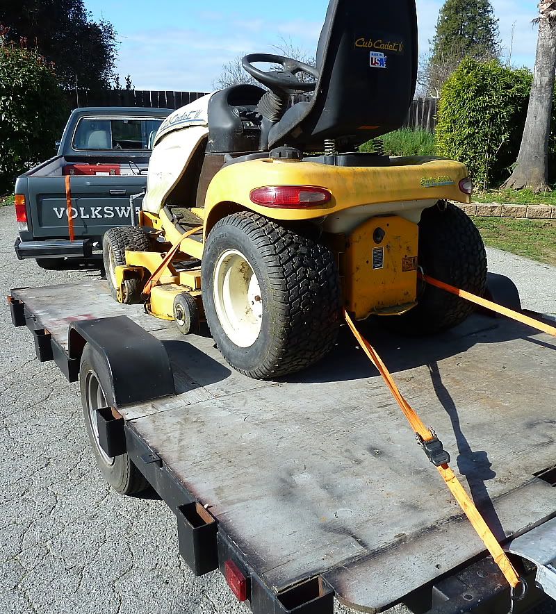

This 3235 popped up on CL this week about 3hrs away. It was listed with some very poor cell phone pictures, and seller knew nothing about it, as it was his Grandfather's.
Picked it up this morning for $250 and brought it home.
It's got the Kohler air cooled V-Twin. Engine was locked up solid.....but with enough PB Blaster and finesse I was able to get the crankshaft rocking back and forth, and that became half a rotation, and soon a full rotation, and then I was able to jump the starter (ignition switch is broken and missing the key) and it cranks over normally. Didn't do an official compression test yet, but with just a finger over the spark plug hole, it appears to be making good pressure.
Here's some as-found shots:
