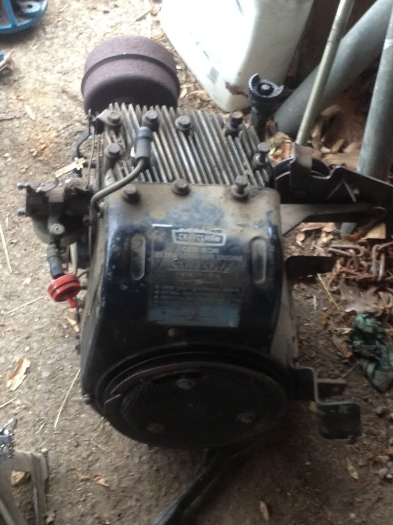

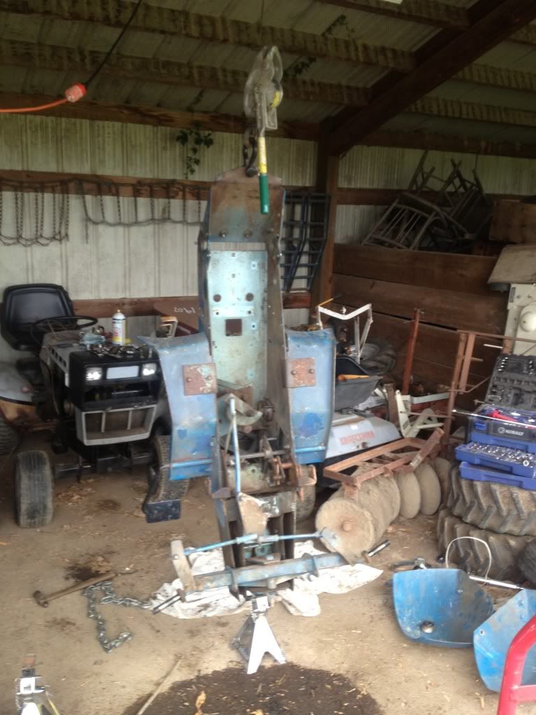

I got the engine pulled today. Also the front wheels and tires, electrical system, and fenders. Its coming along.

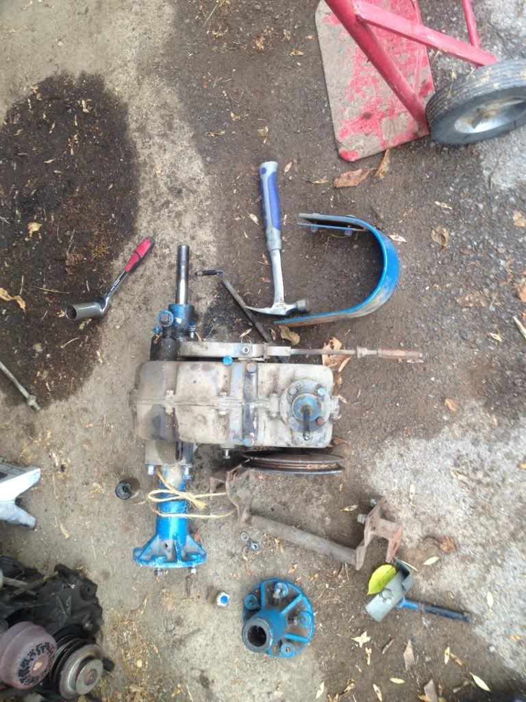

I didn't use the hammer to remove the hub, it was just laying there in the pic. The hub slide off easly

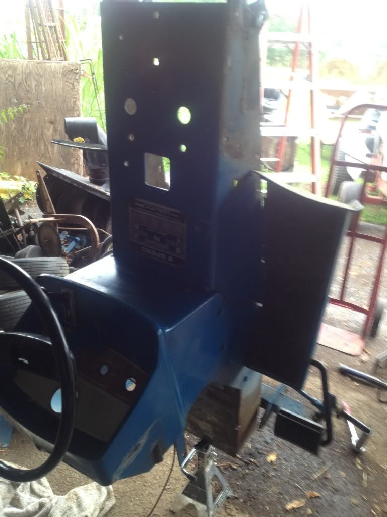

Next is a stop at advanced auto for the tools to remove the steering wheel.
GL with that, hope it goes better than mine did. 44 years without being off makes them buggers.

I have the same Kobalt tool set. The stupid wrenches never stay in place! I see you removed the transaxle without the drawbar plate. Did you drop it out the bottom? I've tried removing them different ways, none work great. Always looking for a better way.
I love my tool set, It easier for me to put tools back in it vs the regular tool box that I have. (ps my stupid wrenches don't say in place either lol).
I dropped it out the bottom. I thought that was the easier way. Turns out there is no such thing.
Yea, all the sockets stay in place when you carry it too. I usually leave the drawbar and tires on and roll it out the back. That works OK.
"GL with that, hope it goes better than mine did. 44 years without being off makes them buggers."
I soaked mine with the acetone/steering fluid concoction (great stuff), and used a bearing separator beneath the wheel to attach a wheel puller. Finally got it off, to find that I had cut a notch in my separator with the shaft key. I cleaned and oiled it before putting it back together. Also, I left off that flimsy retaining ring, drilled and tapped a hole in the end of the shaft, and secured the wheel with a bolt and a flat washer (3/8-16, IIRC).
I cant find a bearing separator local, anywhere. Guess ill have to buy one off the net
Will this work? http://www.harborfreight.com/bearing-separator-and-puller-set-93980.html
